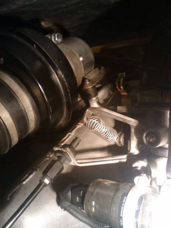

Originally Posted by RSWiser View Post
Don't have a clue. I just discovered this a week or so ago when I was removing the pieces of Sound Blanket. Don't have one right now and it doesn't seem to loud to me.
Going on a road trip this weekend. Probably wait till I get back to screw with this.
Thanks for the info.
Ok, That wire should not be there, I hope it is not functional?

Jim,
Looking at my photos, I am not clear on what I am JB Welding to what.
The threaded part to the washer looking thing?
Rob

That helps. I can visualize what it should look like.
Any tips on how to hold it straight while the JB sets up.
Also once I straighten the bracket, isn't that going to make the cable tighter, requiring some adjustment?

Clamps?
I would first, straighten the metal mount, then adjust the plastic threaded part to insure you have 1.0-1.5 MM of play at the end of the cable that passes thru the Accelerator Arm then JB Weld the Hex End on to the Threaded part. Make certain the glue does not go inside the shaft.
Then Zip Tie it. Using 4 zip ties, make a box of zip ties, surrounding the Hex, the threaded and the metal housing together.
From the pics you posted it looks like it was adjusted all the way out, so you may have some thread left to feed back in towards the rear to actually tighten it.
Jim

It ain't pretty but it works.
Jim,
Thanks for your help. I go to the throttle tonight.
The wire was holding cable tight against the bracket. I think this will work. I threw the wire and some tape in the glove box just in case.
Thanks again.

The zip ties are temporary until I the JB Weld hopefully does the job.
Hewh!. OK If I may suggest, I know this is not OEM but.
If you use Alluminum Foil to lightly wrap the plastic Hex and Thread after you spread the JB Weld, it will keep the adhesive from dripping away from the component.
Set over night, and it should be solid and functional to adjust to proper settings.
Look for the 2 hoses {1 vacuum (small ) 1 breather (larger)} on the Cruise Control drum , reconnect and your cruise should start working.

I drove about 250 miles today. Top off and the throttle worked perfect. Idle is a bit high but I will adjust that.
I think I have an idea for a replacement of the little broken plastic part on the throttle cable. If it works I'll post photos. Probably be about 3 week before I get to in.
