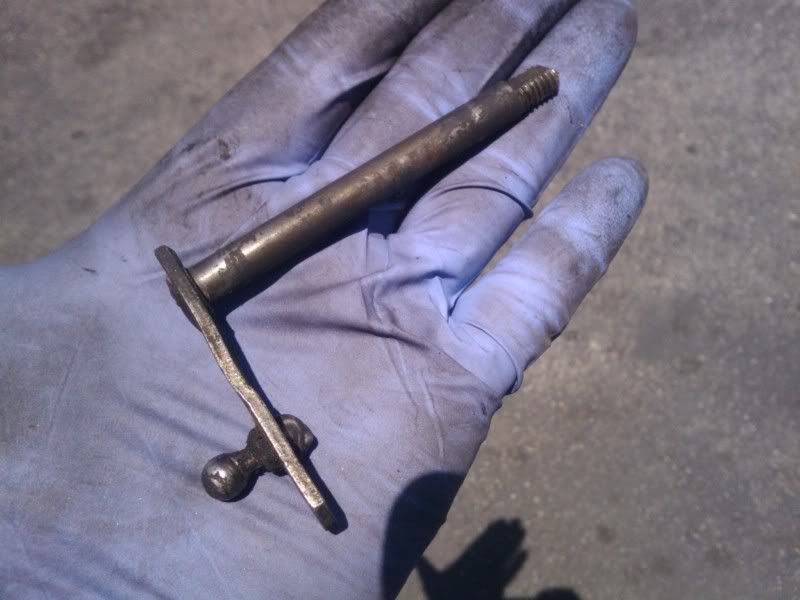

OK Fellas, Here is another DIY:
Amongst other things, I was chasing down a STICKY Accelerator.
Symptoms:
Infrequent Heavy Acceleration, the pedal would at times feel like it was binding on its way down. It was fine on the way up but I generally do not ride my accelerator on it's way up. I hope that makes sense. In anycase, I remove move foot from the pedal when I decel.
The Usual Suspects:
Pedal: New Bushings
Bell Housing: New Bushings
Tunnel: New Bushings
Cruise Control cable at TB, GOOD
Cleaned and Lubed all pivots
Entire Accelerator Assembly Free CLEAR, absolutely no SNAGS or Objects in its path.
Needless to say I was stumped, I pulled the accelerator at the Throttle Body and it still felt sticky on the pull and slow release.
Doubled check buddy's '87 Coupe, absolutely no binding on pull or release
The Not So Usual Suspects:
Throttle Body, Pivot and Bushing or even the TPS may be worn and binding on the potentiometer???. Found Bushing is not Available and calls for a New Throttle Body $510 OMG!
I was already to tear apart the TB until I discovered another set of bushings hidden away that no one had mentioned, at least on my search and Inquiry Thread.
I always thought the rod at the throttle body went thru the tin and down to the bell housing, damn even a well respect Pelican thought so too.
Following is my findings and repair:

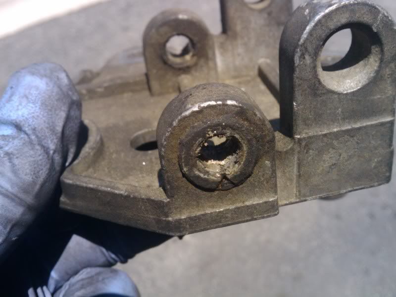

Culprit:
The Two Metal Bushing are worn and rusted at Pivot
3 13MM Hold Down Nuts and Washers on Assembly
1 13MM Retaining Nut, 2 thin Washers, 1 Spring Washer on Pivot
1 Circlip on Accelerator Rod at TB
You will need to remove the Heater Motor and Plastic Heater tube.
If you've worked on the Unholy Trinity of Oils Leaks then you can do this with the Engine in but an Engine Drop would makes things much easier and faster, my 2 cents.

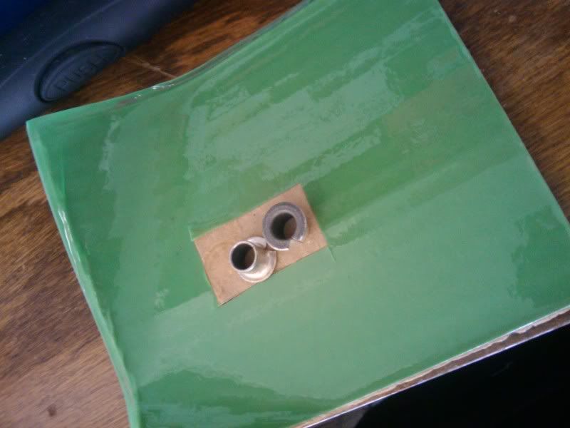

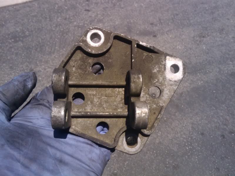

The FIX:
Pelican Part number: 999-924-069-00-OEM $15.00 (set of 2)
When I picked it up, I was expecting nylon bushings like the pedal & bell housing. To my surprise, it came in a box and sealed in an anti static metallic sealed bag. When I opened the box, it was vacuumed sealed. WTF? I still thought it was nylon until I opened it up.
It was metal, not aluminum but steel and some sort of coating
Removal:
Carefully Remove Circlip and place in safe area, you do not want to lose this:
Remove Assembly
Clean and Remove the old Metal Bushings using a punch tool and rubber mallet, they will pop right out, just take care not to scar the Magnesium Assembly.
Using the Mallet and Block of Wood, carefully tap the news one in. The seamed side goes down. MAKE ABSOLUTE CERTAIN THEY GO IN STRAIGHT, these suckers are expensive:
Tips:
On the car, if you detach both rods from the assembly and disconnect the right side pivot arm with the 13MM retaining nut, the assembly can actually be removed out the side and in between the manifolds, just turn side ways and it will slip right out. Besides an engine drop this is the only way to remove it from the engine bay.
Use a Magnet stick to retrieve all washers and nuts.
A hand mirror helped allot to see what you are doing.
Patience, it is really tight in there, not for the faint of heart. One good thing, you don't have to stick you head behind the Throttle Body.
If your little kid likes helping you out, take the offer, his/her small hands and skinny arms will come in handy to squeeze through the manifolds to reattach the 13MM Retaining Nut on the Pivot arm. Just show him/her what you want them to to do when you remove the assembly from the engine for cleaning and installation of the new bushings.
This was another satisfying DIY. NO MORE STICKY PEDAL!!!
