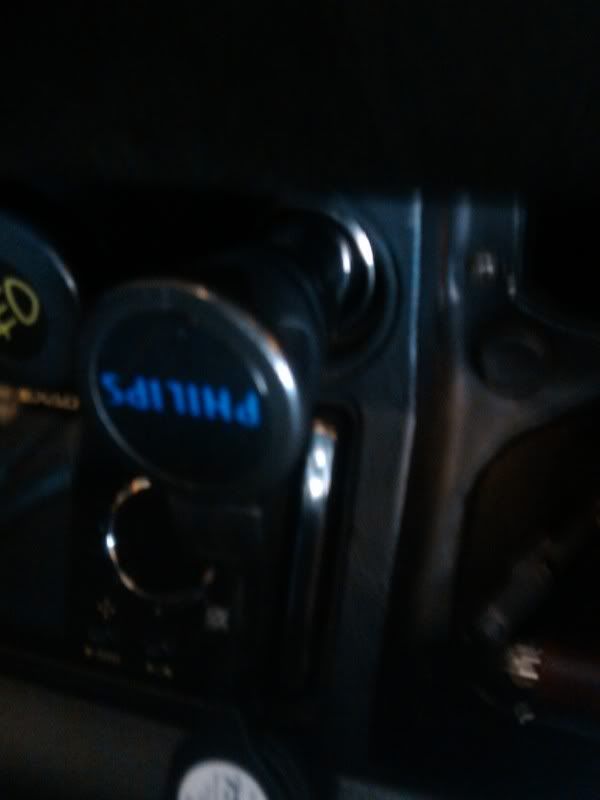

Hey Fellas,
Another mod, just finished in 10 minutes
An Orthopaedic Surgeon and a good friend of SW 911Chip. He is also fellow weekend amateur racer with a Pristine Metallic Gray 87 3.2 Coupe figured out how to fix the Fancy European Cigarette Lighter WELL (that is the U.S. technical term). You won't TRUST it because I didn't at first, but he is a Doctor so I should, shouldn't I?
He is an active POC member, page 51 of the 2011 General Competition Rules and avid 911 DIYer. I know, a Doctor, (I get grief from my clients too) but like me, it is therapy for him, he feels like a kid when working on his baby, Always So Excited.
We just tweeked his alignment and some other stuff then he asked me if I had issues with my charger fitting into your cigarette lighter. I replied with dismay, "YEAH". Then he showed me the SLEEVE he purchased and modified from a FLAPS, a generic Dual Charger. I was like "DAMN", no way , he gave the other one to his better liked friend SW :-(. JKD.

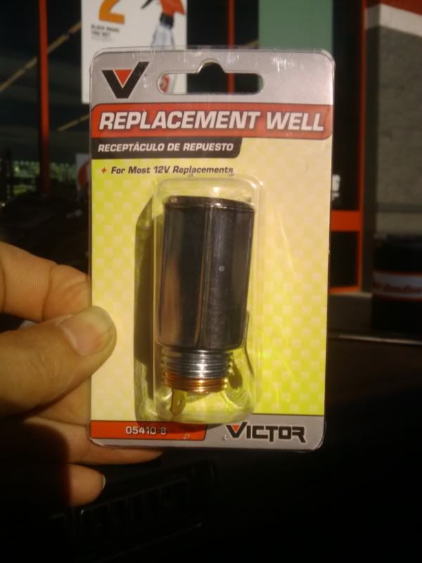

So immediately after cleaning up and sending him off his way to see his lady, I jumped into my baby and drove to the FLAPS. Thinking to myself, "SELF, what if there is just a replacement SAE plug and I can hack that instead of buying a DUAL CHARGER with Cord and Plug that will just add to the Land Fills" No, I am not a Liberal, far from it, I'm a Gas Hog!
OK, went into the FLAPS then two young guys were looking at me funny and said "Hey is that your 911?" I cautiously said "yeeeeahhh?" then they asked me if I knew about Pelicans. I said "of course, on there all the time, I really need a Life". I think they thought I was being snobby, Sorry to digress.
Anyways, wouldn't you know it, first row in front and to the right was 6 complete replacement lighter then to my surprise just the REPLACEMENT WELL
$5.99

The MOD:
For Safety, Leave Car Off while modifying
Issue: Annoying Floppy SAE Chargers on our Euro Cigarette Wells/Lighters:
Part: Any Brand REPLACEMENT WELL:

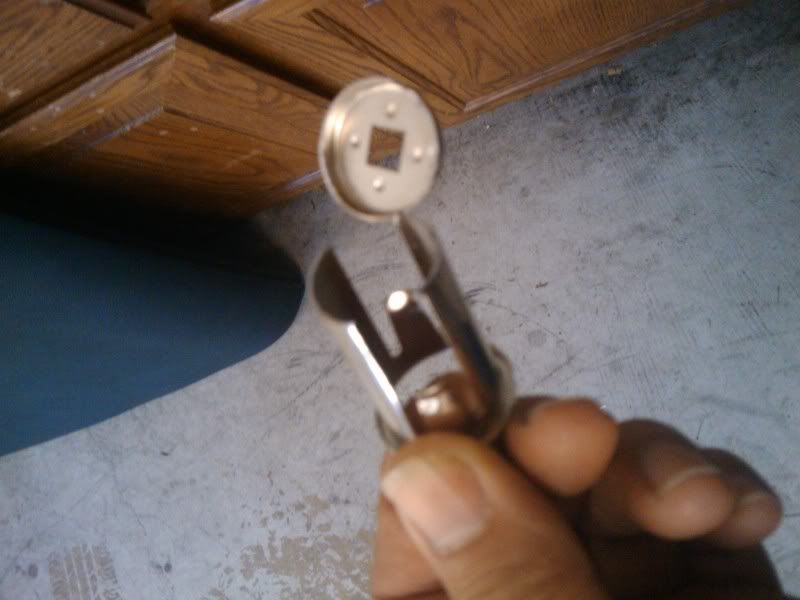

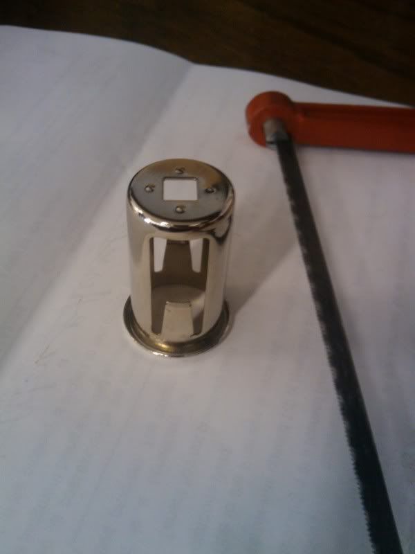

Once disassembled, you are left with the WELL or I like to call the Insert SLEEVE (I.S.):
Use a HackSaw or Dremel to cut the bottom off OVER AN 3/8" Do Not Allow the I.S. to touch the inner OEM well's retaining prongs, it will blow your #6 25 amp FUSE, due to the bent ridge it is just to thick and the charger needs to tap the 12Volt source.
I also used the Dremel to sand off the rough sharp edges, don't want to scratch that OEM Lighter

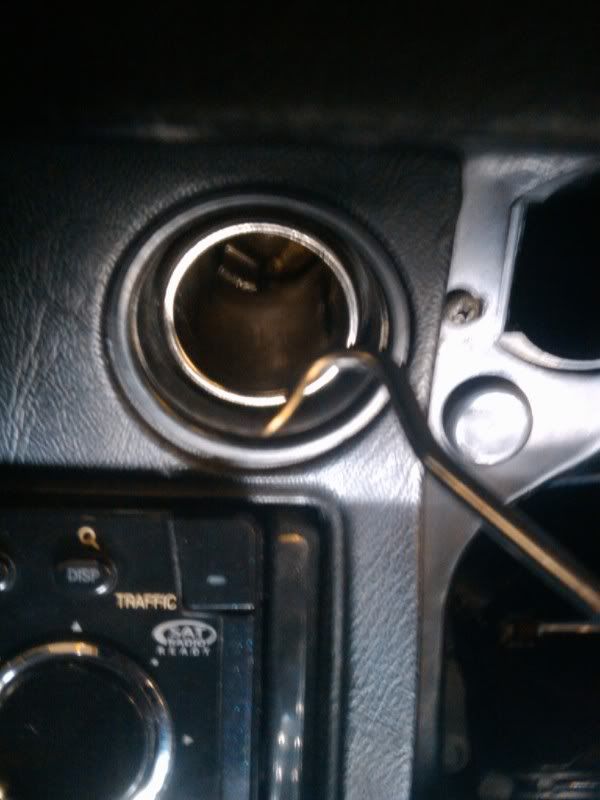

This particular I.S. has tension prongs on the side (as shown above) that will get caught in the OEM WELL, so you will need to turn it 90 degrees to allow it to slip in all the way flush to the OEM rim. If you a have a hooked pin tool, you can go back to OEM/Concours in a heart beat.
Tested: CHARGING = PASSED, tight as a BUG!

Good Side Effects, it will stay in the OEM well until it is pulled out by the Pin Tool shown in the MOD post.
