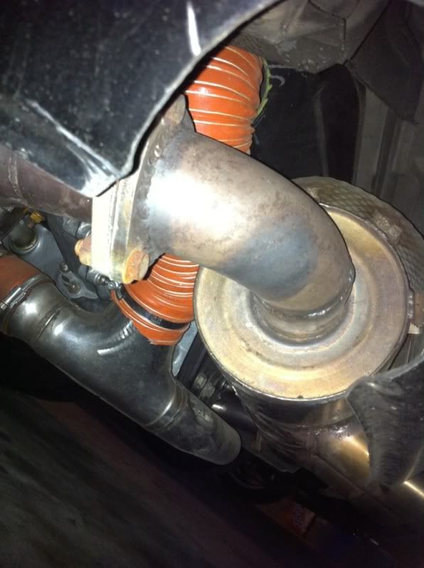

Here is one Ben built for the B&B headers, its a bit loud and I think he only made two of them.

I have no idea - and yes, - I had the 2nd B & B muffler that Ben made.
