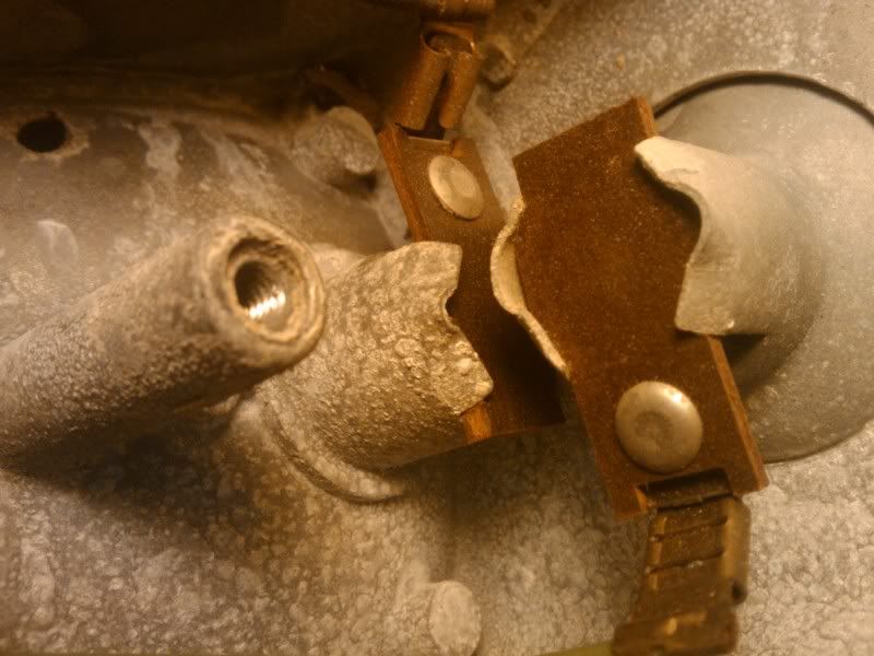

Been having an intermittent issue with the turn signals - they do not work at all. Replaced the stalk a couple years ago so do not think that is the issue. When they are not working the emergency flashers do not work either. Where do you suggest I start?

Have you check to see if you get voltage at the sockets or if the wire connected at the fuse panel is not loose?
Get a DVM to see where the power terminates, If at fuse then probably a loose wire, if good then if at the socket then:
YOu would need to check the PCB ( board ) in the housing it self to see it it is broken:
It is the one underneath. Mine was fractured in half and worked intermittenly but finaly shorted out when the wire hit the housing.
