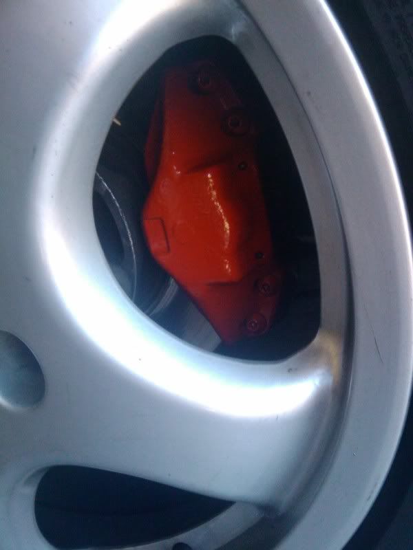

Ok, I am calm now, here is my Caliper rebuilt with Big Red Brake Look using Caliper paint and Heat:
