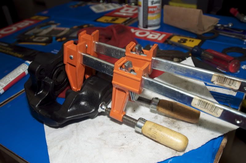

The photo below shows the pipe cap and hand screw I used. The size on the pipe cap says 1 1/4" which I believe is the I.D. of the pipe. The size of the opening or the O.D. of the pipe looks to be 1 5/8". I took the dust cap to the store to get the right size. This size works for my car an 86 Carrera. I like the wood hand screw because it won't mar the metal, but I'm sure you could use a c clamp. Hope this helps.

Perfect!
I am re-installing the caps now, all rears have popped off again.
Thanks Brother!

This method work with me... 2 clamps to keep seal in place, and tap the clip in between the 2 clamps with a piece of wood.... snaps right in.
