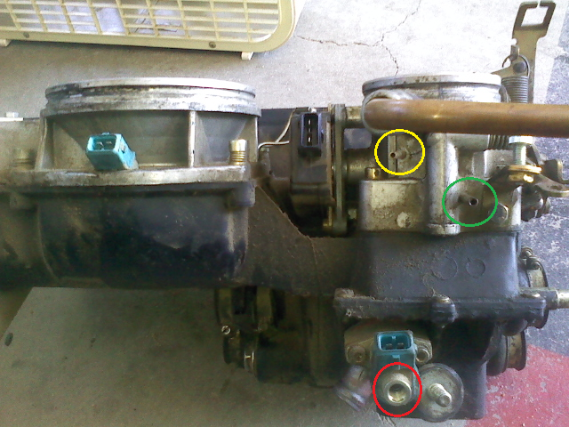

none of the maps work properly :( man. talk about frustrating... spend 20 some hours putting this together and have it not work.
edit: checked for vac. leaks thoroughly - carb cleaner on ANYTHING that has to do wit ha vacuum. all vac lines, all intake runners (tops and bottoms) all check out - absolutely zero fluctuation with the idle.
do i have my dedicated vacuum hose hooked to the right spot?
Yellow circle = vacuum line coming off left side of distributor(as if facing the rear of car)
blue circle - where i have my dedicated line to the Fuel Pressure Regulator
red circle - random hole in cold start valve - do i need to plug?

dont have a fuel pressure gauge... but
double checked both the air temp sensor and the engine temp sensor, wired correctly and installed in the correct spots.
davidbir: yes, the bitz kit gets rid of the CIS air sensor system, except that it needs the Auxillary Air regulator- aar - (for cold start ups) and i was told to run that back around to the large port on the lower left hand side of the cold start valve(in the pic). and on the inlet of the AAR i could put a small K&N filter, or as gsmith said was ok, to run it back to its original inlet on the intake boot.

New development for those who wish to know - Tony informed me that I probably need to calibrate my fuel pressure regulator - the manual says this should already be done - but that part of the manual was from when tony still did the full kits! - - now that he's only doing partial kits, this doesn't come pre calibrated and must be done! He informed me he was going to update the manual so if anyone buys the kit after I did, hopefully you can download the updated manual for it.
With that knowledge, it is obvious that the fuel pressure can f*#^! stuff up real easy. perhaps this is the key to my rough as hell idle? getting a gauge tomorrow morning, and calibrating the little sob and hopefully my super rough idle will go away.
the car really wants to work right - rough idle, turns out i had a couple of busted injector O rings, got em replaced. idle was still rough but the backfire thru the intake went away. so maybe the Fuel Pressure Regulator might be the "well if i fix this..." ticket to win.
