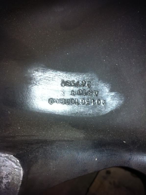

I found some fully polished 5.5Jx14 real fuchs rims with caps and new tires for a very good price. The numbers on them are 90136101600 , AS152, 26738 and they have the fox head. The owner couldn't find the date codes.
I've been looking at several sets and most of the early sets have the second number as AS108. Again the ones I'm buying say AS152
Are these wheels the correct offset for an early 911. Are all 14 inch fuchs the same offset? I'm under the impression that all of the 14 inch fuchs are the same.

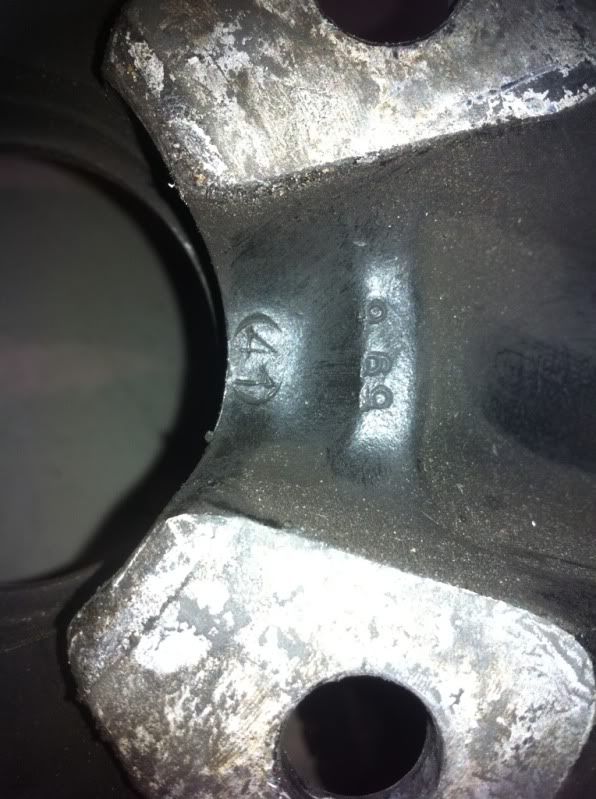

The first number is the same as mine and the date should be on the hub right next to it. I think these were used on all early cars? mine are off a 69 912

Right, I know where the date stamp is but the owner of the wheels couldn't find it on them.
What is the significance of AS152 as opposed to most of the "14s having AS108 on them? I'm just trying to make sure the offset is the same for all of the 5.5Jx 14s.

Fuchs 5.5x14 are ET41, 5.5x15 are ET42, 4.5x15 are ET42

Awesome, thats what i needed to know. Thanks bill.
