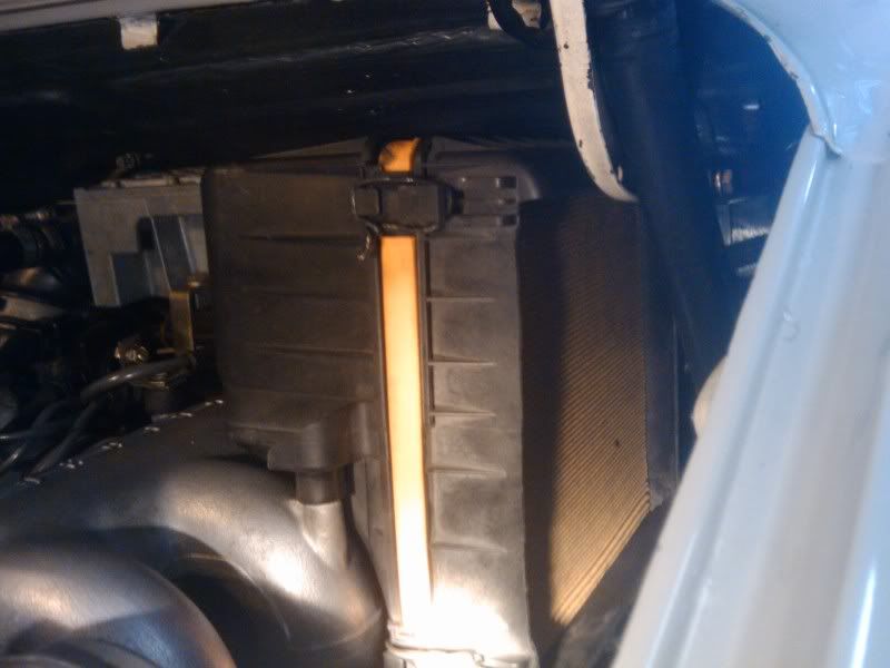

Well, if you want a couple of HP's, if you have the OEM Air Box, mod/cutting the cover will give you 3 HP's
Steve Wong recently dyno-ed a 3.2 and for test sake removed the OEM cover and logged 207 from 203 HP gain.
