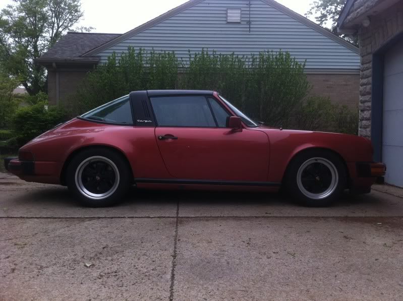

Posts: 4,306
this is my 83Sc, all stock suspension, just tuned to my liking.
- He gave his father "the talk"
- Once while sailing around the world he found a shortcut
- He taught a german shepard how to bark in spanish
He is.... nineball. I don't always drive sports cars, but when I do I drive a 1983 911SC Targa. Stay fast my friends.

I had a 76 912E lowered like Reifle's. For me, that was a little too low as I kept bottoming out over just about any larger bump and I had to go up most driveways at an angle. (My front tow hook really took a beating.)
My current 81 911SC looks kind of like that ad. I would like to lower it, but I don't want to worry about driveways and bumps like I had to with my 912E. Nineball, do you have any problems bottoming out or on driveways scraping? What is the height of your fender bottom lip to ground? Also, are you on 16-inch wheels?
