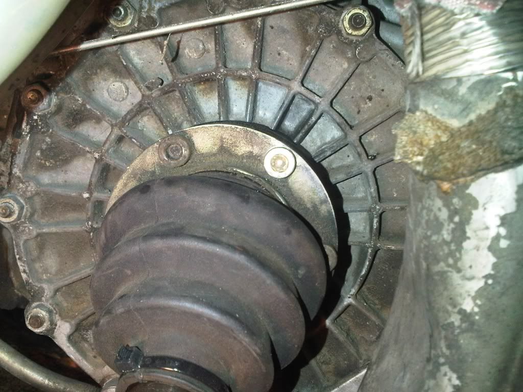

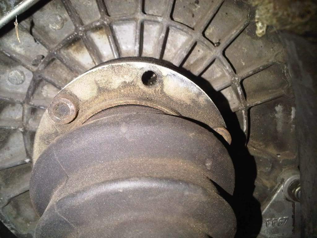

Um, am I missing a bolt here?
Just me, or is this a conspicuously open hole on the axle/CV assembly... (as a matter of honor, I didn't do that, I'm the newbie trying to sort her out after rescuing her)

Oh my, YES!
It appears it had the Scorse (whatever it is called) washer but seems like it did not work.
When you replace, re-torque all bolts after 500 miles in a star pattern.

Fun eh? I'm thinking I'll fix this before driving her again.
Any idea on the size/thread? Or should I pull one of the ones actually there and match it up?

What year is your car? I can't tell what trans you have by the pic.

She is a 1974, looks like 900-067-211-09 from the Porsche catalog.
Any reason not to pull one and make sure it matches up? I'm specifically asking since she has a 3.2 in her and with all the stuff I am finding, well who the hell knows what else has been done.

Originally Posted by tdskip View Post
...Should I pull one of the ones actually there and match it up?
That would be the safest way, just measure and order a couple/several in case you round the hex on one or two while torquing the rest

74 is suposed to have 4 10mm bolts and those look like 8mm so the hubs are installed to match the halfshafts.

Pulling one is a good idea. You will get length from it.
There are two sizes used: M8x1.25, and M10xsomething. So easy to tell which is which by putting a spare bolt of known diameter in that hole. If a 10 won't fit, it is an 8.
There are 4 bolt CVs, and 6 bolt CVs. The 4 bolters have two dowel pins, making them sort of 6s. I think all the 4 bolters used 10mm bolts. And I think the '74 came with these.
If it was just an engine swap, with the transmission original to the '74, you should be good with '74 parts. With tranny swaps you run into issues getting the CVs to match the output flanges on the tranny. And changing output flanges runs into coarse vs fine spline issues. And so on. But just an engine install ought not to affect the tranny and CVs.
The toothed washers are Schnorr (?sp) washers. I think getting proper torque, and retorquing after some running miles, are the most important factors in keeping these bolts in place.

Fixed - turns out I have the 6 bolt M8x1.25 assembly.
Now just for everything else - ha.
Really appreciate the help guys!
