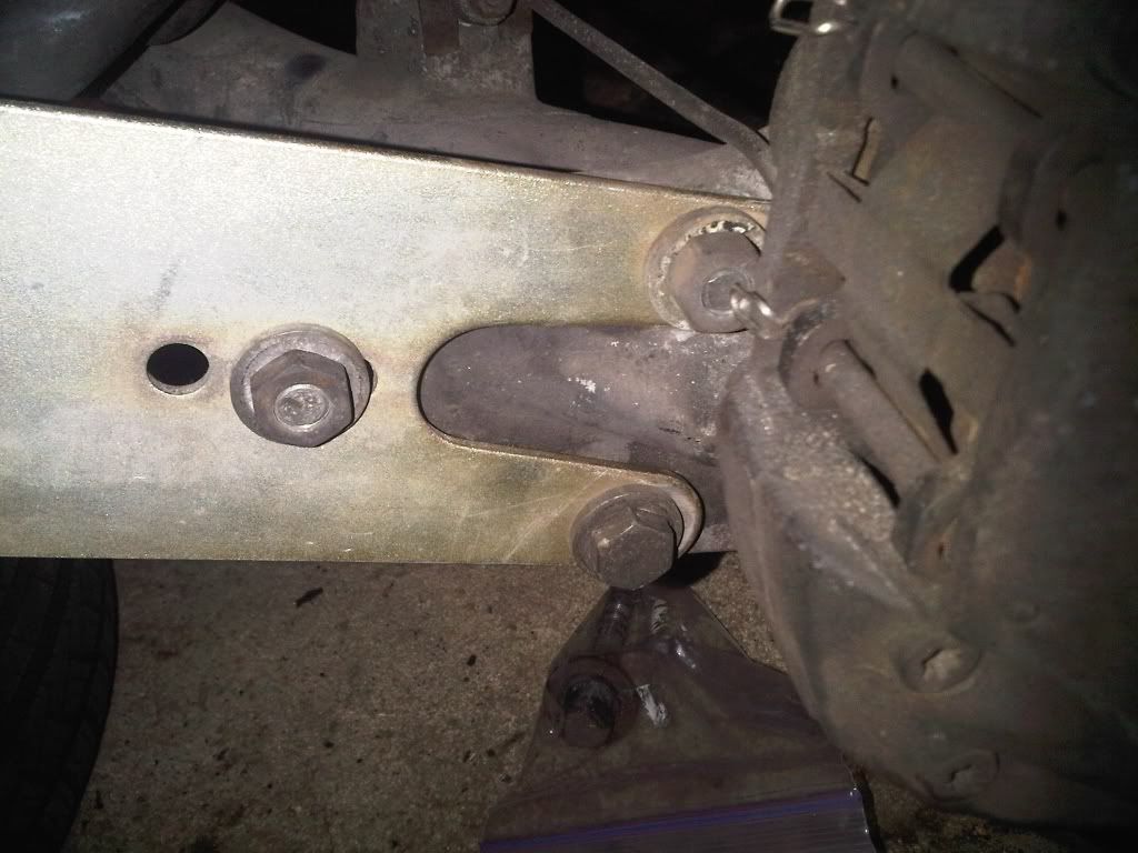

Hi guys - now that the missing CV bolt has been dealt with it is time to button her back up. I'm a newbie here, so bear with me, but it appears that the bolts that secure the spring plate to the trailing arm have a range of adjustment. I'm not sure if they should be installed centered in their track or all the way forward or all the way back.
Pic with the trailing arm slid all the way towards the rear of the car in the plates;
Pic with the trailing arm pulled all the way towards the front of the car in the plates;
I had non-adjustable spring plates on her to start with if that makes a difference.
And coaching for me here?

Sorry - once I put the toe adjustment bolt (in the open hole in the pictures above) in it aligned everything properly. Like I said - newbie.
Pretty darn cool how adjustable these are - clever design.

Oh my, do you have a alignment rig set up while doing this?
Forward if toe in vs Back to out
Up is Negative Camber, down Positive.
The problem is PAG designed it so one effects the other.
You also need to remove the pre-load by bouncing and rolling the car forward and back to get the proper readings.
If you have not done so search the String Method Alignment rig setup, I found that to be the best way to align, but it takes time an patience. If you have OCD, it will take longer, ask me how I know.
The idea is to think diagonally as you adjust

To answer your question about the 2 bolts that hold the spring plate to the trailing arm, they are there for clamping only. Their final position will be determined by the final alignment settings. As you have already seen by playing with the eccentric bolts, the net effect is that the trailing arm moves relative to the spring plate as you adjust for camber and toe, hence the need for the slots.
Hope that helps,
-Doug

FWIW, when I disassembled my rear suspension to replace all the bushings, I left the camber bolt in place attached to the spring plate. When I went to reinstall everything, this bolt helped align the trailing arm exactly as it was before.
After getting the ride height set, the suspension was in almost perfect alignment.
The only adjustment needed was to reset right rear camber from -.50 degrees to -.68 degrees.

No thread locker or special nuts for those bolts. Just tighten them down to at least the spec torque. They won't come loose.
