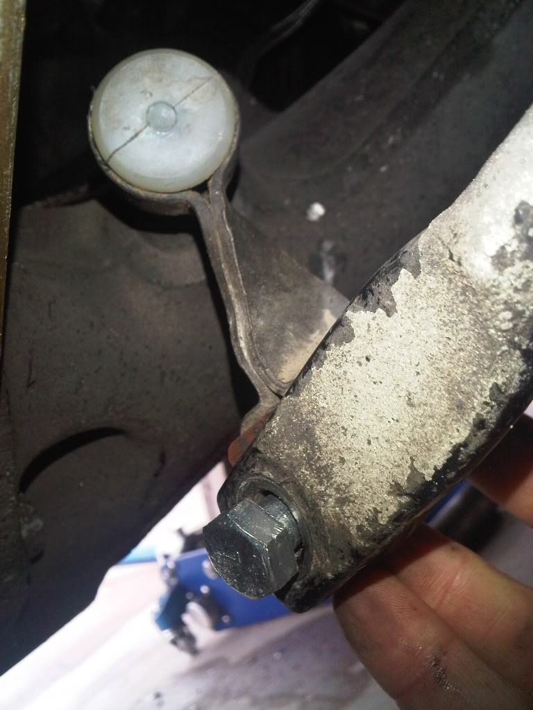

Can I switch gears a bit and ask about the rear bar I bought? This was listed and confirmed over the phone as being a "drop in" for my '74. I don't have access t the car and the bar in the same place, so forgive me for not actually trying it.
This looks right as it will push on to the mounting point on my trailing arm.
These drop links will work fine. They have already been modified to work with the later style 'bolt thru' bars. (See that bronze bushing in there?)
You now have to get a matching bolt long enough to go through everything and not have any slop in the drop link bushing (diameter-wise), once hooked up.

Thanks for the note Bill. Very willing to admit if I'm wrong here, and I am a newbie, but I got a 20mm stock bar and not 22mm front bar I ordered and paid for.
Again, hope I'm wrong here but I don't think the later year bar I received will work with the stock mounts on a 1974, will it? Won't the rear bar that I was sent require new mounts be fabricated?

Depending on what hardware you received with the purchase, you should be good to go. In fact, those modified drop links will accept a range of diameters, whereas the stock - unmodified - links will only accept different diameters if you swap out the rubber bushings.
If you still have the mounts on the car you showed in your first post - you should not require any fabrication.
Again, if you are running anything heavier than the stock 18mm bar - keep an eye on the factory mounts and welds - especially if you have to really tweak it to get it back to spec.
btw how are you measuring the diameter?
fwiw, I'm using a 22mm bar from an 87 on my 77 with a modified drop link - no problems.

Hi Bill - thanks for the help.
I'm using a digital caliper measuring the bar at mid-point. Is that correct?
Here are some pictures of how the bar would need to fit based on what I have;
I didn't receive any mounting brackets, and please excuse the obviously incorrect bolt, it was just there to help mock it up.
The bar will be required to be mounted at a downward angle if that matters. Totally open for other ideas / corrections if I've got this wrong.

That's the ticket.
do yourself a favor and replace those black bushings on the chassis mount. downard angle is normal.
Here's the bolt that I used: McMaster-Carr 95430A423 M12 x 80mm, 1.75 mm pitch, 10.9 Stl, hi viz Blue Hex Cap Screw. (of course any M12 x 80mm should work)
Bill K
