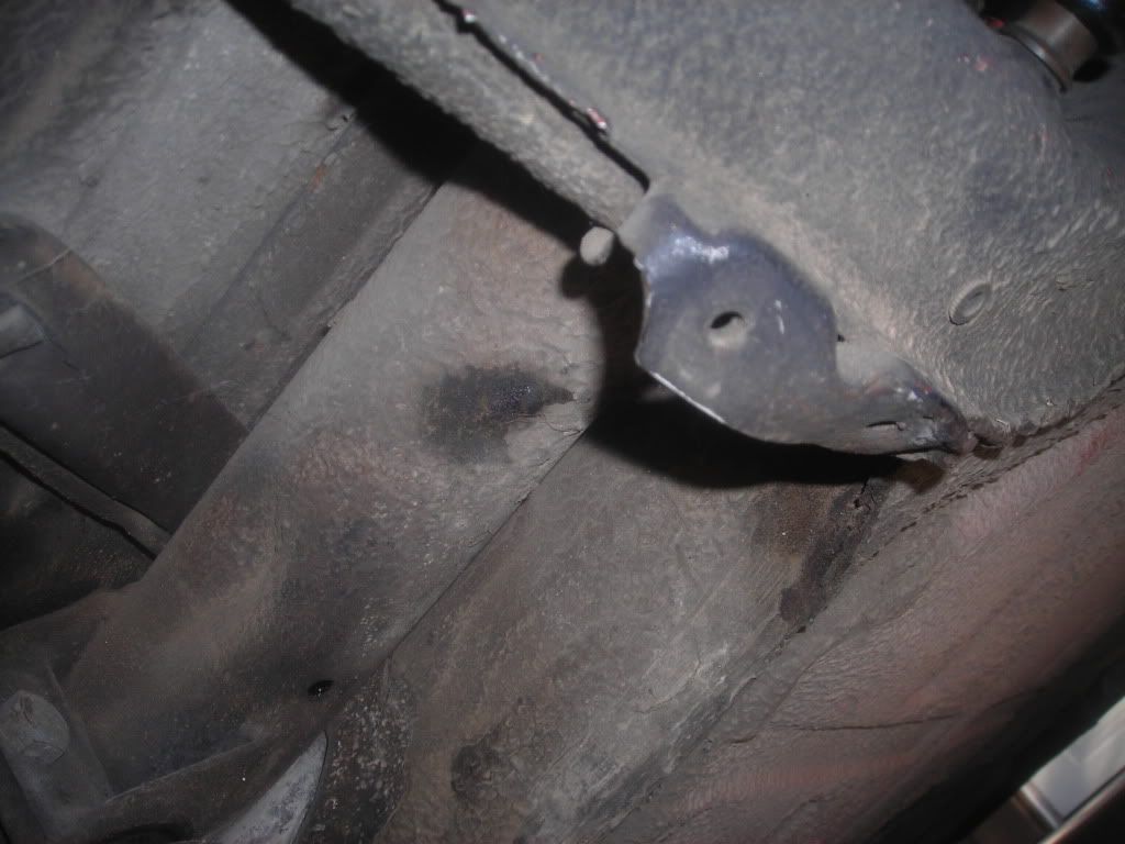

Hi guys - my car didn't have a rear bar on her (which is correct for the year) when I got her and I'd like to add one.
Is this my factory mounting point? Yeah, know it is bent.
Think I can bent it back without it weakening the metal too much?
Thanks guys.
Old 01-14-2012, 06:43 PM
Member 911 Anonymous
DRACO A5OG's Avatar
Join Date: Sep 2007
Location: Rancho Palos Verdes
Posts: 14,329
Yes it sure is, check the weld points for fracture after you bend back. You should be fine.
If the mount nuts are stripped ( they are very soft), use SS Grade 8 Bolts and Lock nuts from ACE. They woked great for me.

Best thing to do is to weld a reforcing plate on the inside of the mounts, and keeping the orginal mounts.
R/Dave
Old 01-15-2012, 02:24 PM
Walt Fricke's Avatar
Join Date: May 2004
Location: Boulder, Colorado
Posts: 7,275
I'm with Dave A. If you had no mounts at all, either a torsion tube mount or a much reinforced weld-on mount like the WEVO would commend itself.
But you already have mounts. If you reinforce them (which is not hard if you can weld at all, and not expensive if you can't), they will stand up pretty darn well even when abused.
Reinforcing typically amounts to cutting a piece of siutable sheet metal to roughly the size of the vertical part of the mount, and welding it on, creating a kind of enclosed space where the nuts are. Someone also sold a sort of X shaped reinforcement, allowing access to the nut in case it strips or its weld breaks and you need to hold it with a wrench for R&Ring the sway bar.

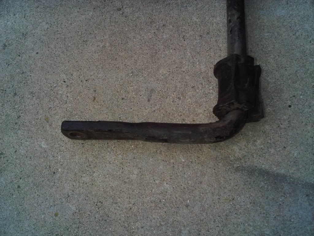

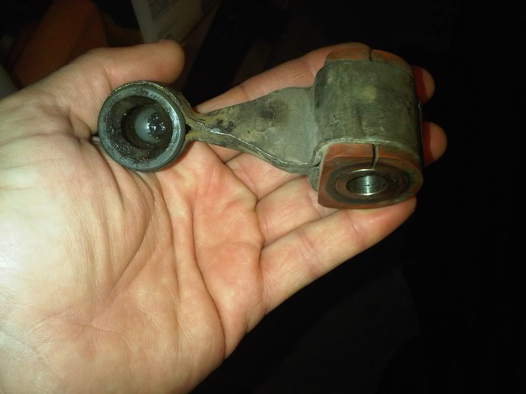

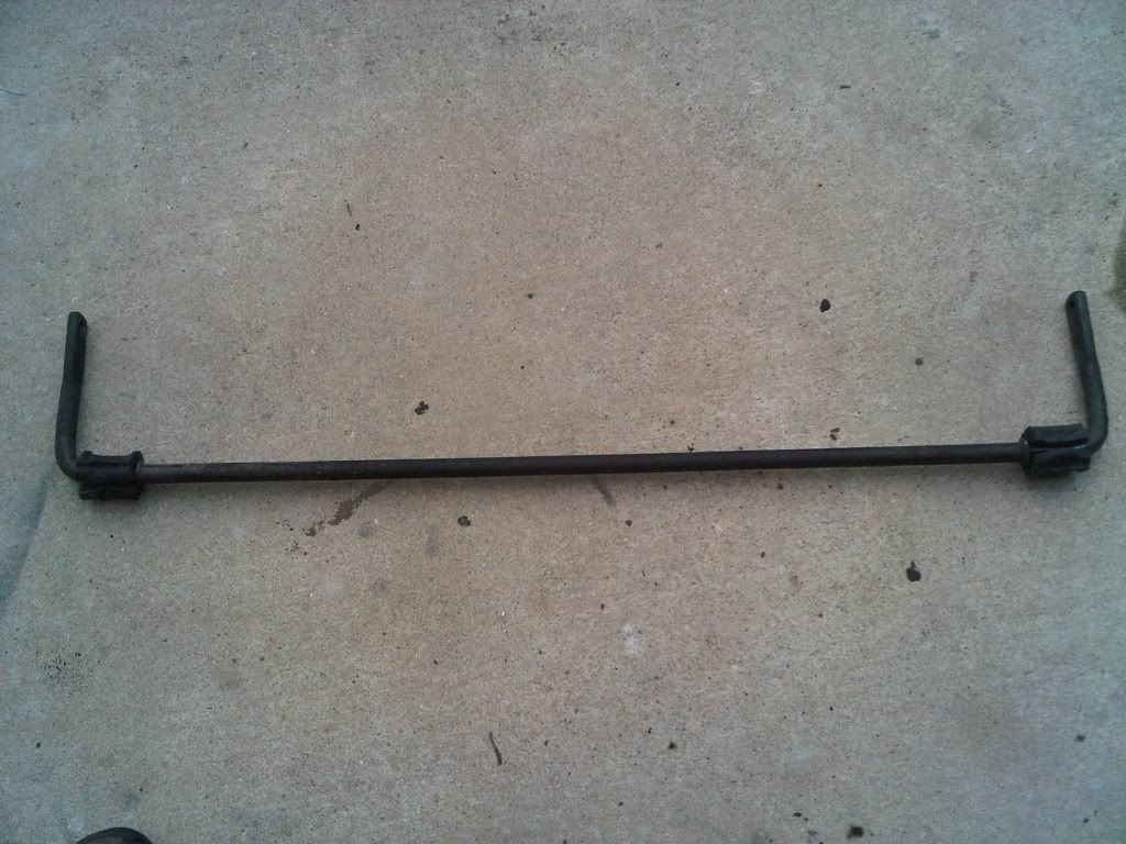

Can I switch gears a bit and ask about the rear bar I bought? This was listed and confirmed over the phone as being a "drop in" for my '74. I don't have access t the car and the bar in the same place, so forgive me for not actually trying it.
This looks right as it will push on to the mounting point on my trailing arm.
Here is the bar side detail.
And detail on the side.
Old 01-15-2012, 04:21 PM
Join Date: Jun 2009
Location: Clarksville TN.
Posts: 553
Porsche Crest
Looks like you have got the right drop links but you have the wrong swaybar. Your swaybar looks like one from a later model 911. I think you will need one for the early model cars. Here is what I have on my 1976 911S. The swaybar in the background is the early style and the one in the foreground is the later style. Hope this helps.

If you have an 18 mm rear bar, the front bar should be 20 mm. This bar set is the "Carrera" option. If the front bar is thinner, you willlikely have a lot more oversteer.
Some of the rear mount solutions, like Wevo, are made for later year models, that is the bolt spacing is 10-20 mm wider, so you will need bigger straps. The good news is that you can then buy poly bar mount bushings, which are not available for the 74 narrow mounts.
