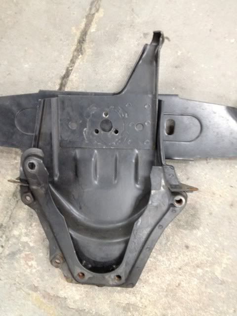

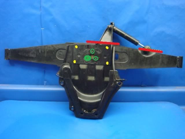

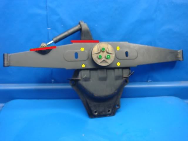

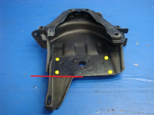

I have a Carrera Cabriolet engine mount and I want to make it a solid mount
Can I modify this mount so that my engine mount is solid ?
I was thinking of Drilling 4 holes and adding the bolts/nuts like the solid type and cutting all the shock type stuff off.
Keep the bolts for the donut hole as well
Green = original threads
Yellow= new holes for Bolts/Nuts
Red= Cut off
These images were borrowed from an ebay auction
Any one done this before ?

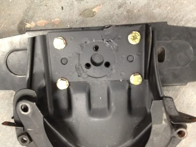

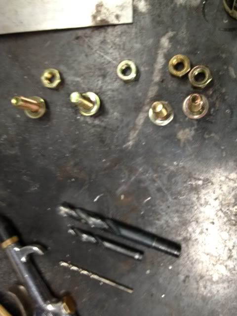

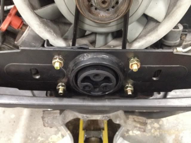

I did it anyways !
This mount feels pretty thick (more so than I remember a Coupe version)

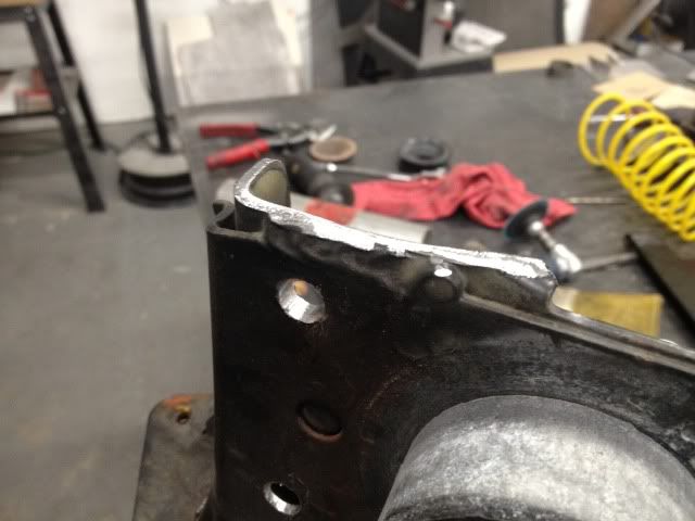

I put the mount on a vice, Drilled the holes where I wanted them
It took 4 different drill bit sizes
4 10mm nuts
4 washers
4 locking washers
4 10mm nuts
While I was at it, I removed the shock mount
It came out pretty good
This is what I started with
the shock was literally Blown! it could completely move with just a hand touch.
sorry about the pic
This is the hardware and 3 of the 4 drill bits used
Holes drilled before going to the last bit
Cutting off the shock mount

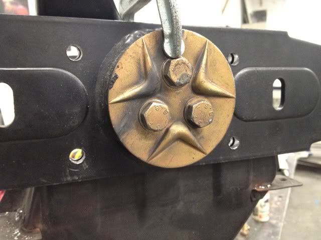

Final Product !
Not too bad

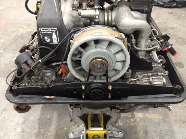

Eventually I will get the proper engine mount.. but for now this will do better than what I had.
Mounted on the engine
I'm hope this makes a bigger difference

Looks good! Keep in mind, per factory manual, when you install the engine, after the 4 engine mounts are tight, loosen your 4 bolts on the crossbar to let the engine 'settle' and not be tweaked by any angle you may have when you assembled the crossbar. Just loosen all 4 and then re-tighten them.
