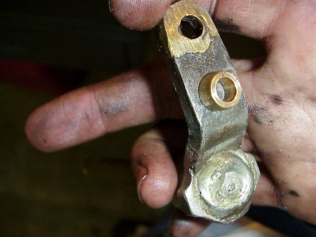

Some of the plastic bushings were definately worn...especiallt the two that support the clutch pedal shaft. (One even had a hole worn through the side. So, it all went back together smoothly, no major problems... I did notice a couple things though:
For starters, when I pulled the floorboard, I imediately noticed that my cluster is missing the clutch pedal return spring.... hmmm...why would someone take that off?
So, I'll get a replacement.
And secondly, it sure looks like at one point, the lever on the clutch pedal shaft has been broken and cobbled back together... I don't know for certain, but it sure doesn't look factory, and I had one extra small bushing that came with the rebuild kit that I couldn't find a home for... I suspect that the extra bushing is supposed to go in the hole on the clutch pedal shaft lever but I'm not sure.

That's the end of the shaft where the clutch cable connects right?
It doesn't have a bushing.

Somebody brazed-up the hole on the lever after a previous bushing wore through and the hole got egg-shaped ... doesn't look like a bad repair job, though!

Are you flipping us off, or the job itself???

Oh, I knew someone would say that it looks like i was flipping a bird...
It was really awkward trying to hold the shaft in a way that it was recognizable, balance the bushing and take the picture... so that's just the way it is!

Looks like the hole is too small for that bushing. Those shafts are still available if yours is too messed up...

I must disagree with Chuck. The hole you show is meant to have a bushing on rebuild, at least that is where the small bushing in my Pelican rebuild kit fit. When I removed the pedal cluster that hole was oblong from the trunnion pin's scraping over the years, and this notching had the effect of making my clutch pedal action uneven. How did the trunnion pin itself look? Was it worn away?
Of course, since the PO brass-brazed that puppy you how have the perfect medium on which the trunnion pin can ride. I would consider drilling it out and puttting in the correct bushing anyway though.

Well, I guess my suspicions were correct.
The trunion pin is worn pretty badly, I knew that last year when I replaced the cable. I just bought a new one as well as a clutch return spring from Pelican.
