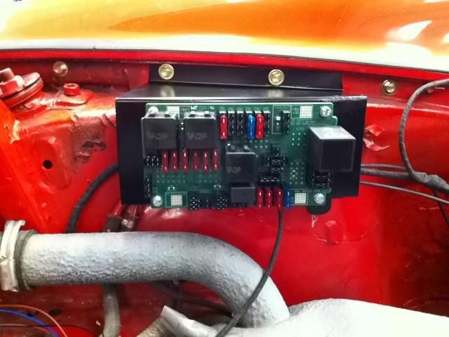

My 77' 911 has been gutted completely. So i'm putting it back on the road, and ive thought about putting modern wiring and fuses/relays. Any ideas on where to start?

This would be a great start.
ATO Fuse Panel...Last call before Christmas!

Fred's kit looks cool.

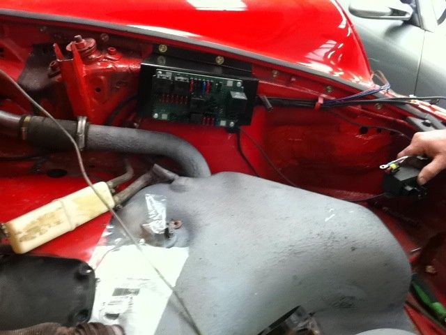

This is what I have and am very happy 7 years into it.

Here's a second recommendation for fred's kit. I put his kit in my 82 and haven't had a problem with it.
