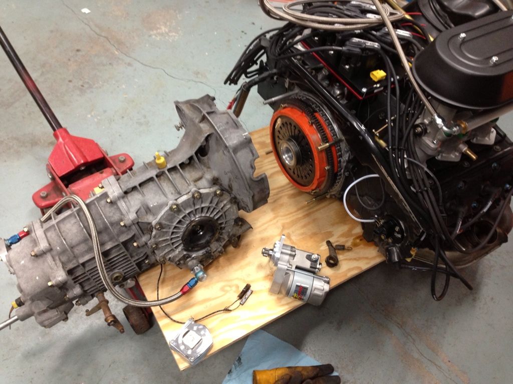

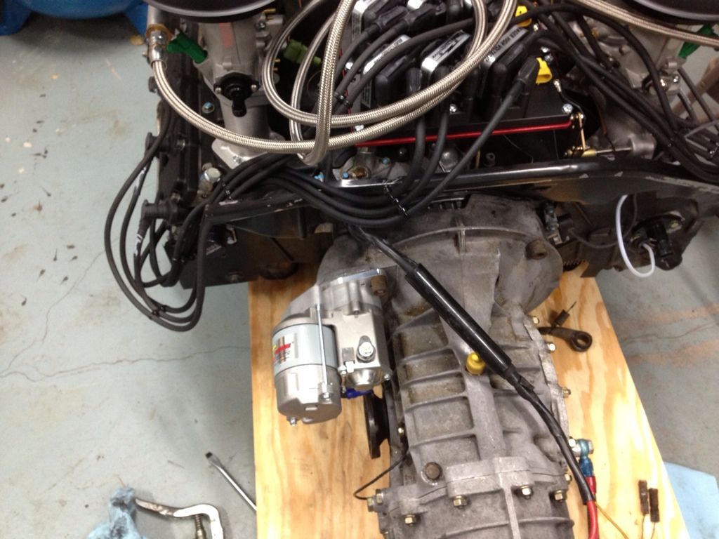

Today was the first moment of truth.
I've always felt there are three big milestones in any build:
1. Installing the engine
2. First start
3. First drive

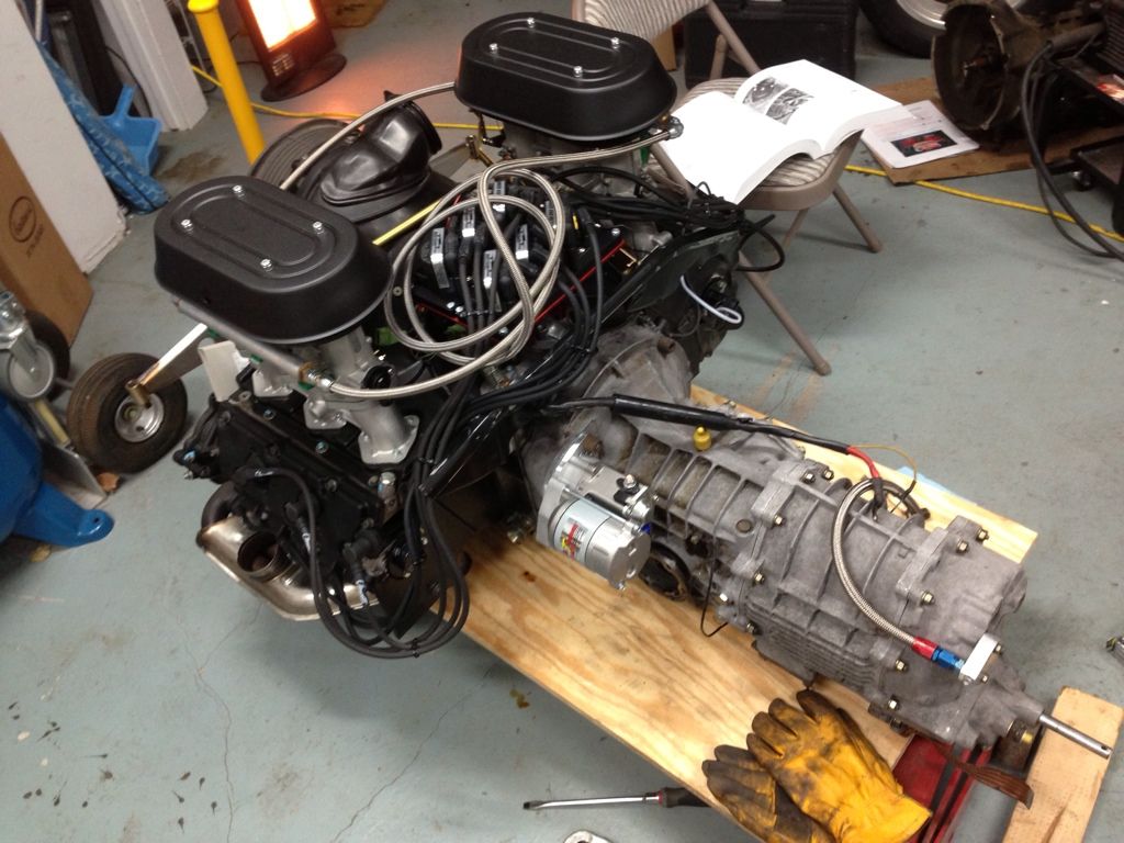

I guess attaching the tranny is often one of the more challenging parts of getting the engine ready.
This one slid right in with only a little hesitation as I made sure the fork engaged the t/o bearing properly and I turned the output flange slightly until the splines on the input shaft lined up and it went right in.
My hardware is pretty crusty. I think the barrel nuts are the same ones used on the heads? I'll have to check that out.

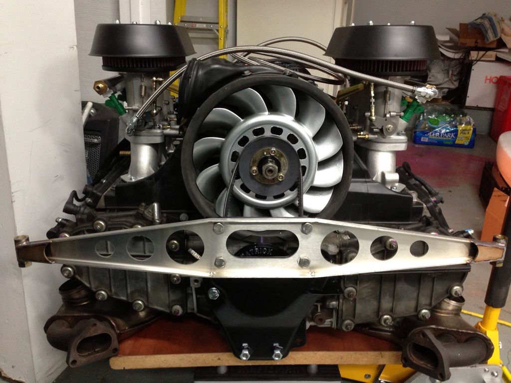

I guess it's the little things that count. I did get my engine tin in the mail (thanks Andrew) and manage to run the engine console through the blaster and give it some paint, then bolted on the crossmember:
Ain't she pretty!
She looks bad as****** that looks frigging sick!

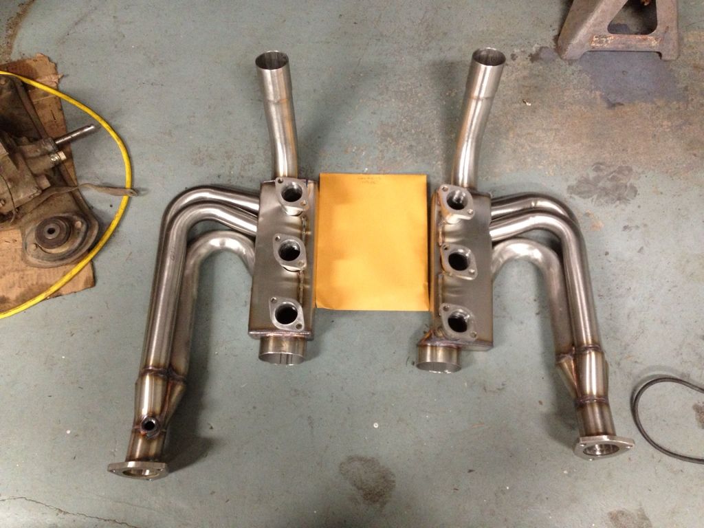

On a happier note, my BB 1 3/4" headers showed up today!
Now that is exciting!

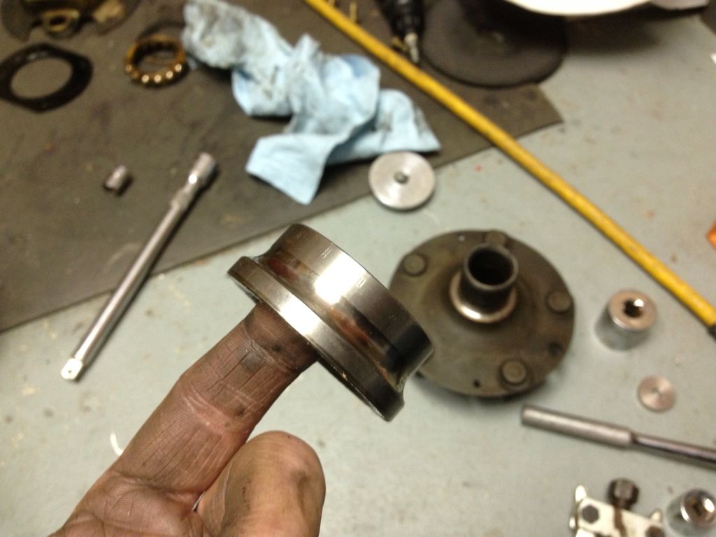

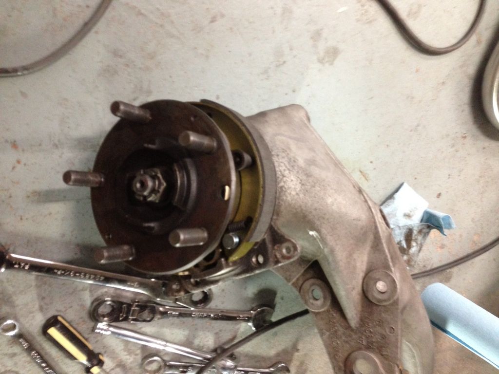

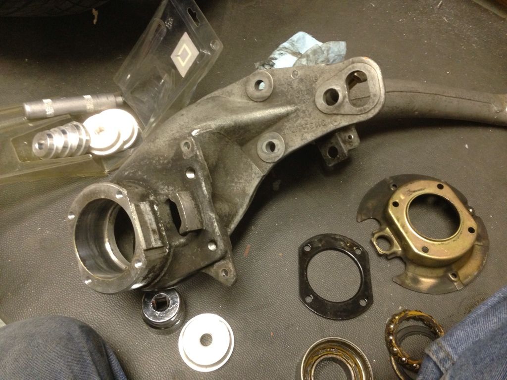

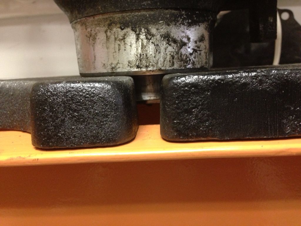

Started the suspension and brake overhaul today. Got the driver's side apart and rebuilt the trailing arm.
When I pressed the hub out, half the inner bearing race came with it.
Fortunately, there was just enough of a lip that I could grab it with the puller and off it came.
I heated the oem rubber bushing, pried each half of the sleeve out, pushed the rubber bushing out, and then drove each half of the stubborn outer sleeve out of the trailing arm pivot. Then pressed the Elephant monoball into place and secured it with the circlip.
I was able to press the rest of the wheel bearing out using the largest seal installer on the back side of the arm.
Victory!

I then pulled the new bearing out of the freezer and pressed it into the arm. Actually, technically I pressed the arm onto the bearing.
Then pressed in the hub (after reinstalling the e-brake mount and bearing cover). The housing from the old bearing came in real handy for several operations including acting as a spacer to keep the wheel studs from hitting the press base.
Ready to be reinstalled after I change out the TB and replace the spring plate which should arrive tomorrow.
All said, it was a great day. I took the wife out for breakfast and she was happy. Got to work around 12:00, so a good 5 hours of work. If the spring plates and caliper paint show up tomorrow, I'll paint the calipers and rotors and replace the TB and spring plate. I have to go to Las Vegas for our annual sales meeting on Wednesday, so it won't go back together until next weeekend. Oh, I also have the remove the old sway bar mount and weld in the new heavy duty one. The work is just never done!

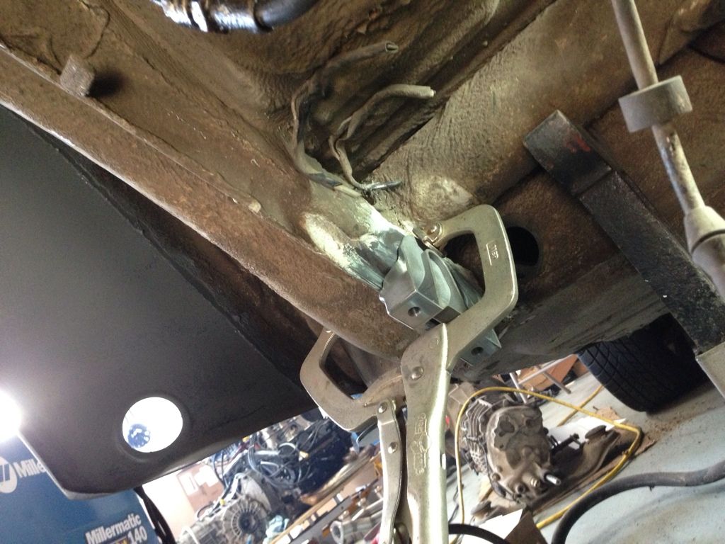

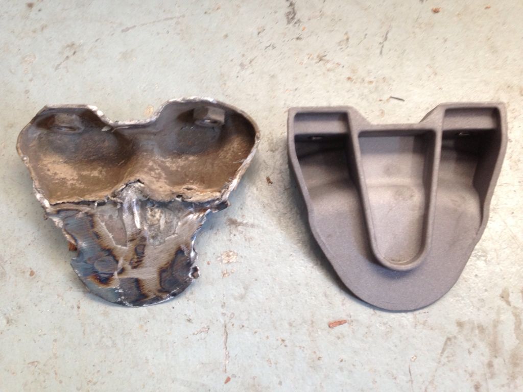

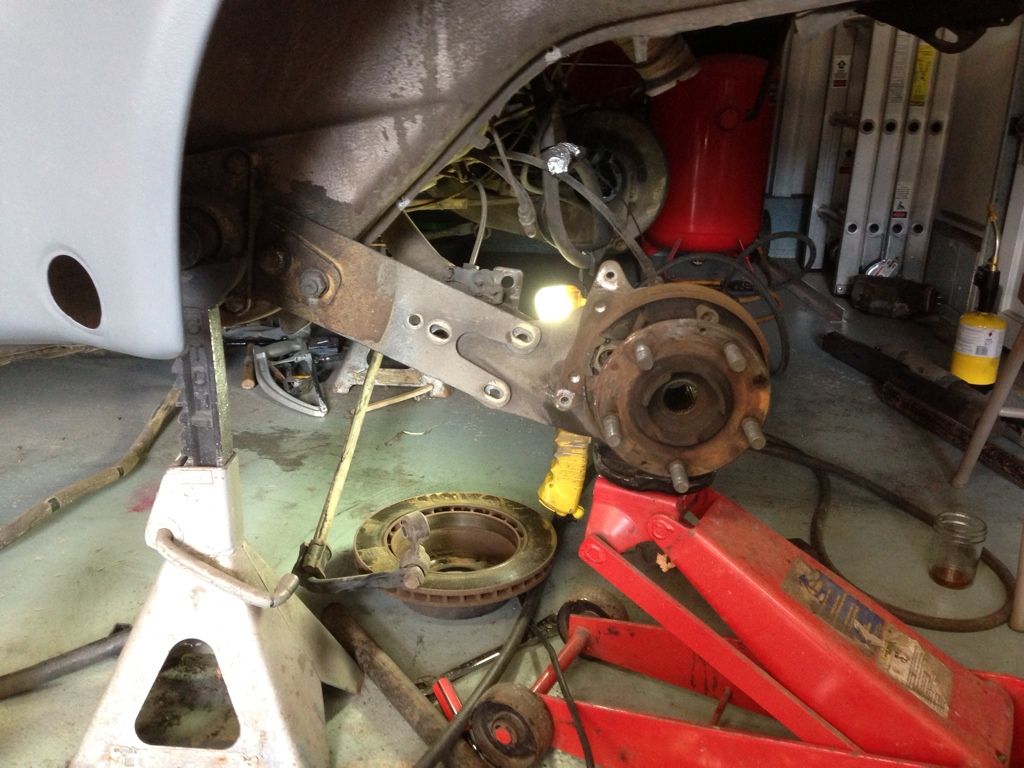

So I pulled the cover, spring arm, and tb. Check out the difference between the 24mm stock tb and the elephant 29mm.
I also ground off the weak stock sway bar mount and welded on the much beefier upgraded version.
Here's the new one clamped:
Welded in (with poly bronze bushing pressed in:
So tomorrow this side goes back together and I start on the other side!

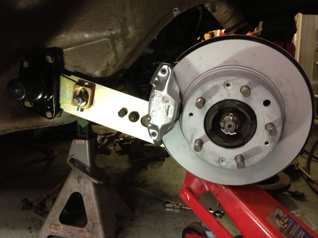

So much for big plans! I don't think I was focused today. I put the trailing arm on, but had the spring plate too low. Took that back apart. Then I installed the e-brake cable (that was a *****), installed the rotor and caliper, and then realized I forgot the cotter pin in the e-brake cable nut. All back apart again!
Finally all is together and looks great! I decided not to paint the plating on the caliper. Turned out to be a good move as I leaked brake fluid everywhere.
Tomorrow afternoon I'll start the other side. I need a break and a drink or two.

Posts: 307
How did you decide where to weld your new Wevo mounts? It turns out they are a diffent shape than the original ones so my markings don't really work? I still have my engine/transmission in the car and they come very close to the transmission mount. Any reference points?
