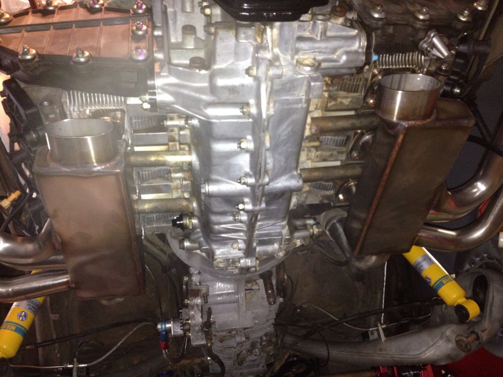

Here are a couple shots as I bolt it all together for transport:

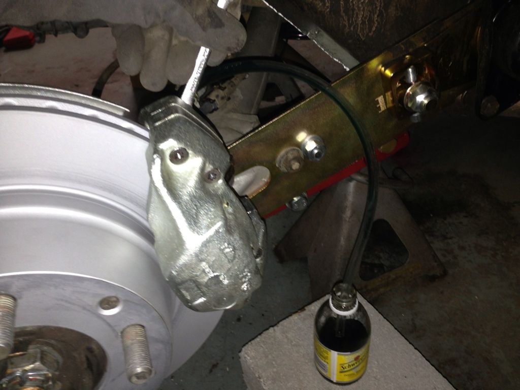

I bled the rear brakes and lower the car to the ground for the first time in several months.
I bought this brake bleeder about 20 years ago. It comes with a variety of adapters and one screwed right on to the top of the master (same one that fit my Cobra master cylinders). One end clips over a tire valve stem for air:
Air flows to a regulator that you adjust to 15 lbs. you fill the plastic reservoir with clean brake fluid, and attached the quick disconnect to the fitting on the mc adapter:
Then open the bleeder until the bubbles stop. A few taps to the caliper helps:
Easy as pie!

You can actually go up a few PSI on the bleeder. We all use the Motive one, and I have had it cranked up to about 24PSI. It totally speeds up the process.

Thanks, Chris, it spiked up to about 30 psi when I first connected it and I thought a brake fluid explosion was eminent!

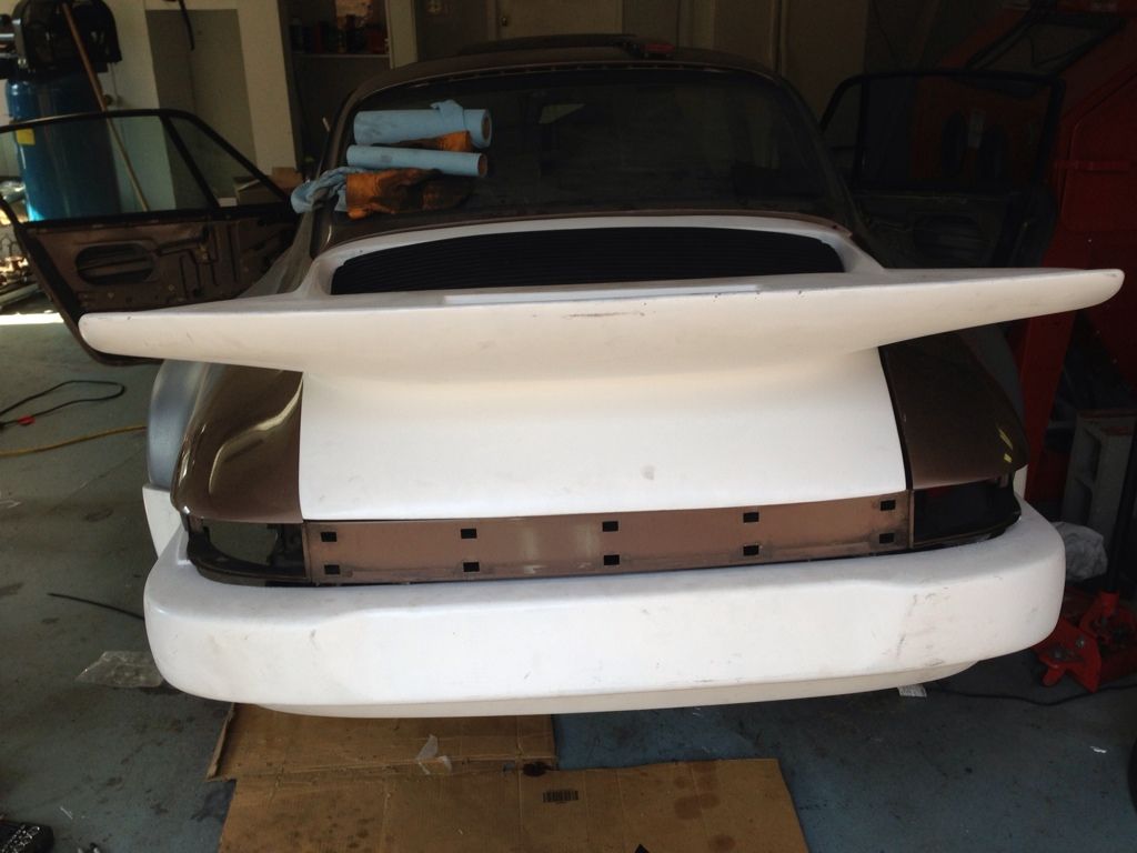

I pushed the Porsche out of the garage for the last time last night and of course we got a little snow. Here is the last shot taken from the second floor window just before I load it on the trailer and head south.

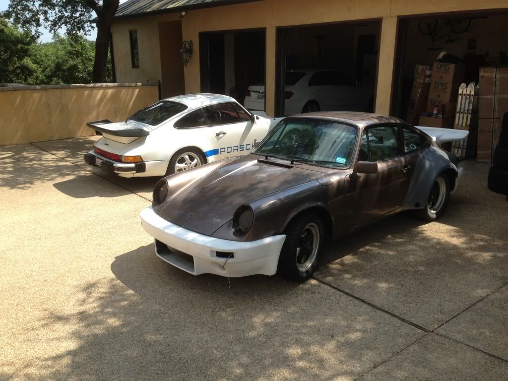

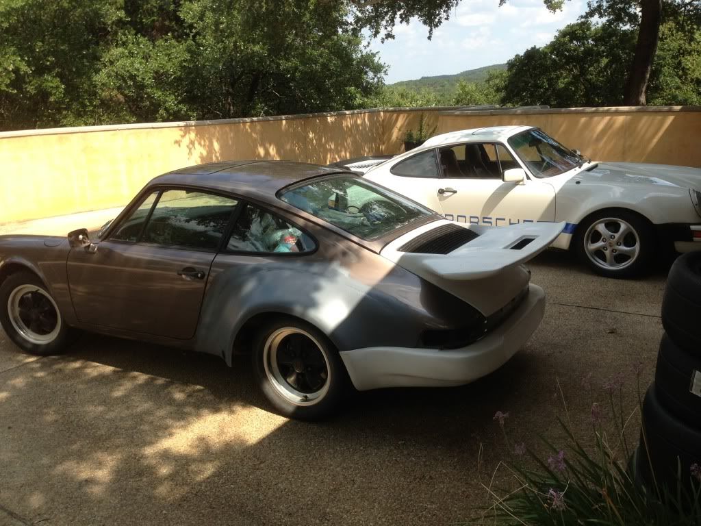

Finally was able to bring the car over this morning. I'll get back to work tomorrow.
I took the white '74 out for a cruise around the hill country today. The 2.7 does ok. Not a lot of power, but enough. When warm, the oil pressure is very low, coming up with the rpm to about 30 psi. I'm sure it is tired. It also doesn't have hydraulic tensioners or a pop off valve for the cis. Just a matter of time...

What muffler will you be using with bb headers?
