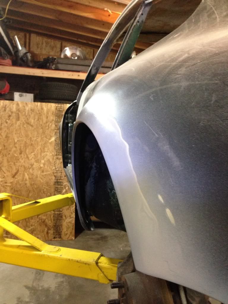

Quite enjoying the parallel work, although I think you have done this a lot more than I. One question about the fender work, was that all hammer and dolly work or did you graft on new metal?
It looks like that it is all stretching and hammering out the crease that is there or was it a very large PITA to do?
Dennis
Old 11-26-2012, 12:28 PM
cnielsen's Avatar
Join Date: Sep 2002
Location: Lake Tapps, WA
Posts: 3,070
Thanks everyone...glad this is useful for all of you. I also look for threads when I'm doing a project and need some assistance do I need to do my part at posting.
The fender is just done with hammer/dolly and a little portable planishing hammer. No extra metal was used.

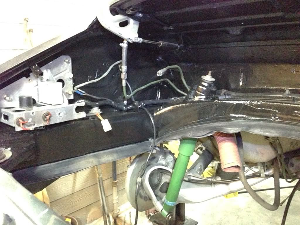

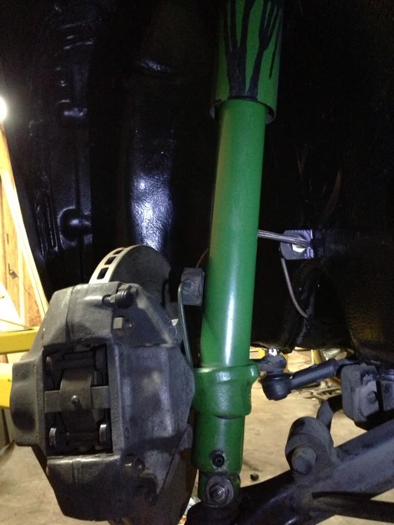

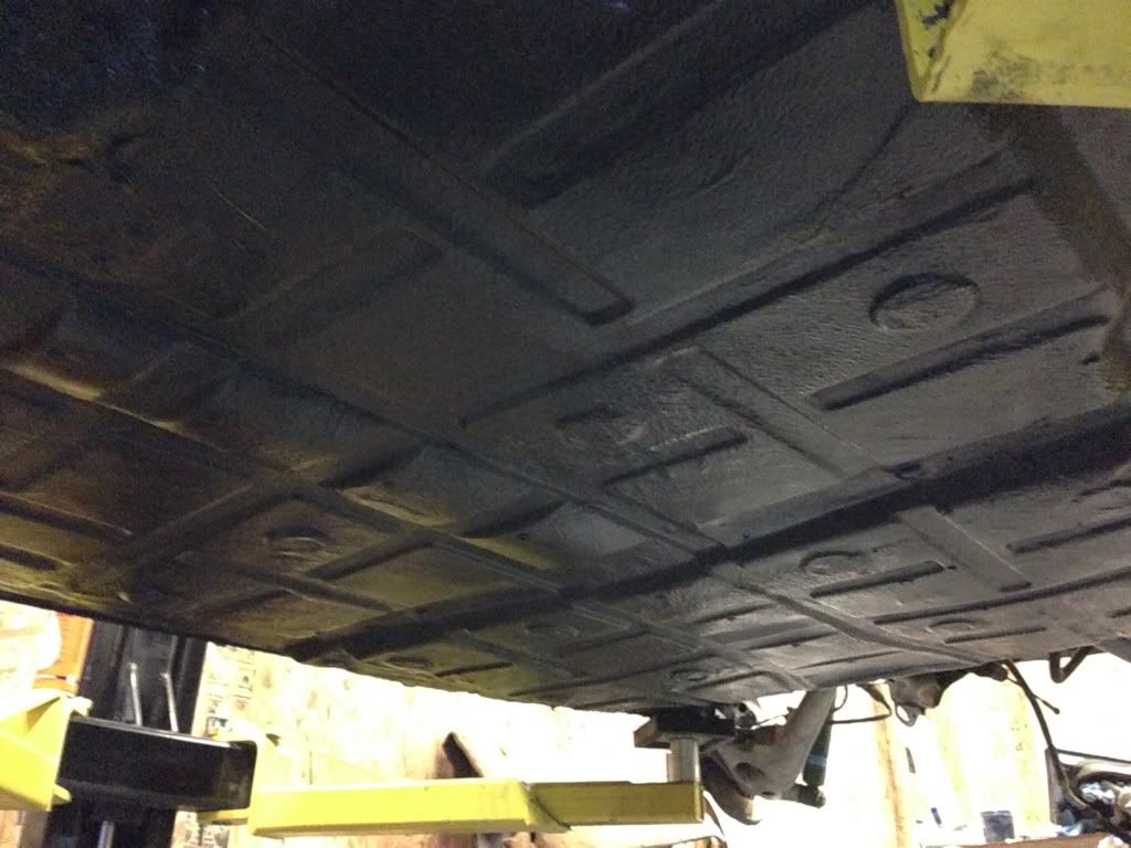

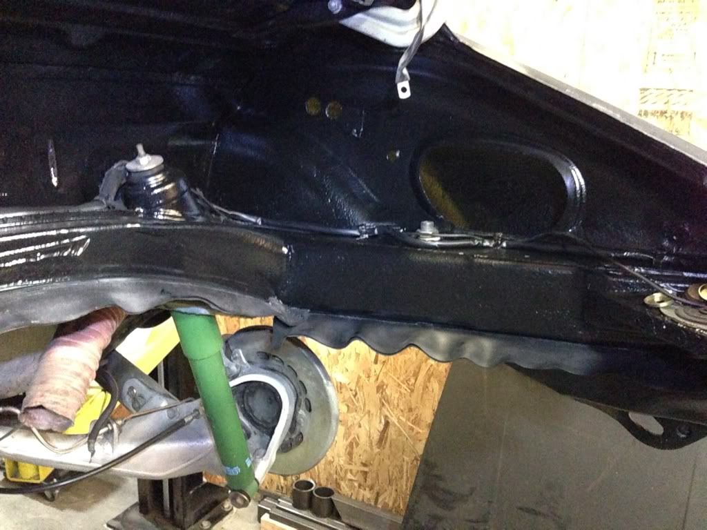

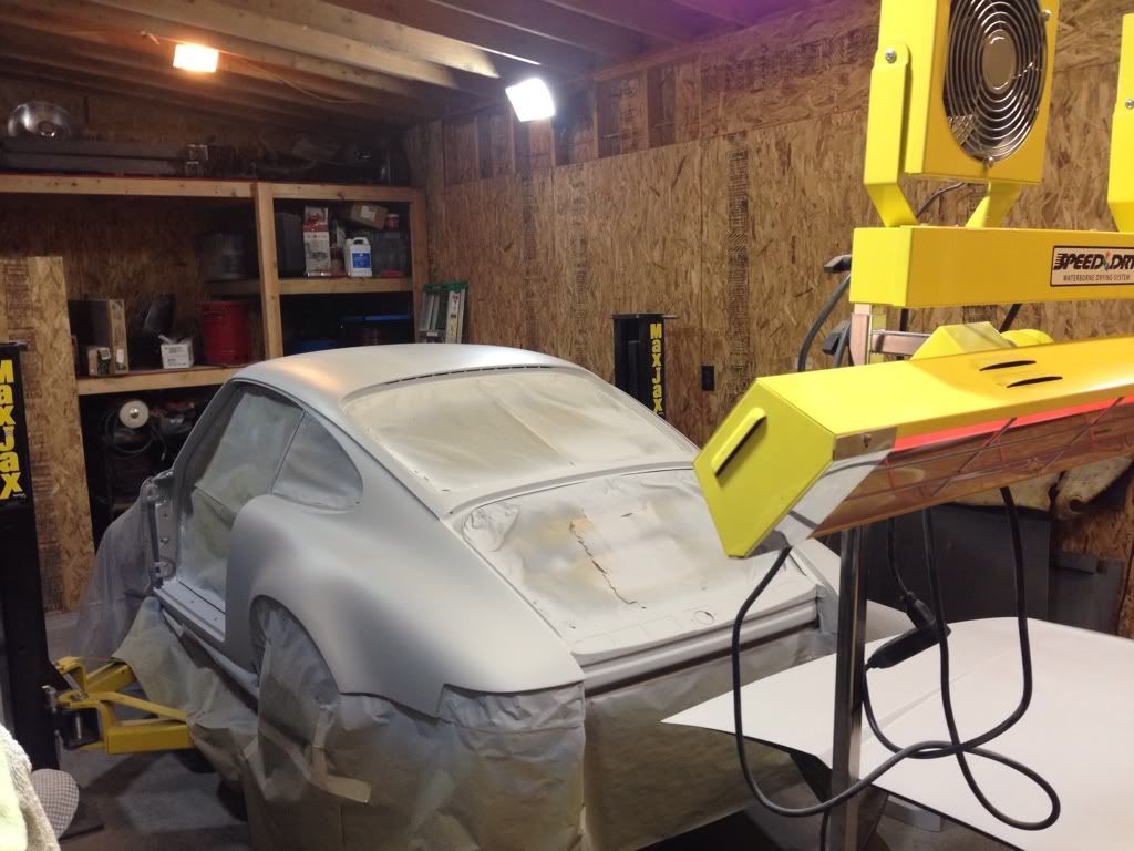

I've been working on the car but I feel the progress has been not worthy of any updates or photos. The under carriage has been cleaned and painted as well as the trunk and engine bay. I opted to paint everything black for simplicity and keeping with the low budget theme The paint is called Polane. It's a catalyzed Sherwinn Williams Paint that many of the high end resto shops use for frames and under carriage components. So far, I am very happy with the results and touch ups should be easy if they are ever needed. I sprayed the large areas and brushed or rolled the smaller, hard to reach spots.
A few photos and then hopefully I can get some sandable primer on the body and start prepping for paint.
I don't want concours...just clean and functional. Kerosene cleans up the excessive brown cosmolene. I think Herman the German was messing around with that shock bolt so ill get it replaced with a new one.
The black paint on the shock dust cover was there from the factory...not me

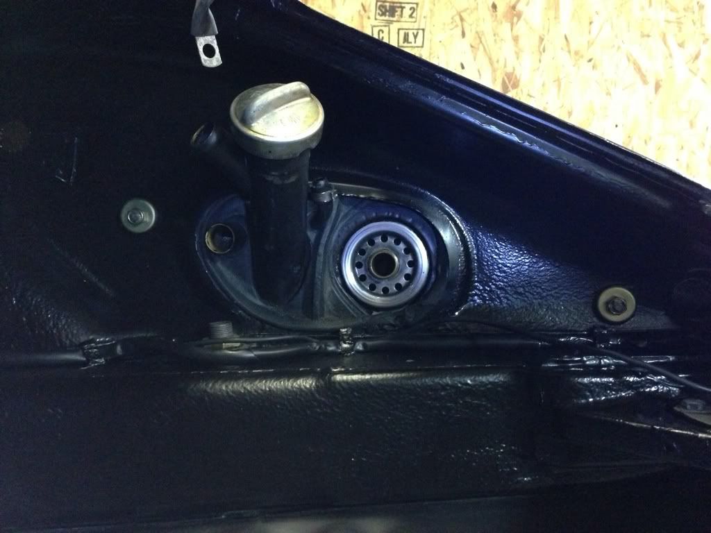

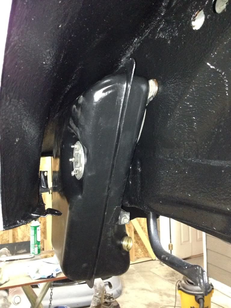

Cleaned, refurbished and installed the oil tank...
Trial fit of the hand made 100L fuel tank... This was the original tank to the 911SC. The old tank was stripped inside and out with Caustic acid and phosphate coated for rust prevention. Baffles were installed and we replaced the top section of the tank to replicate the shape of the 100L tank. The swirl pot and fittings remain so it will hook up to the original fuel lines.

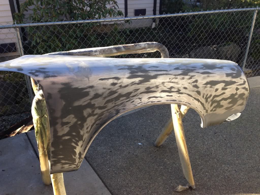

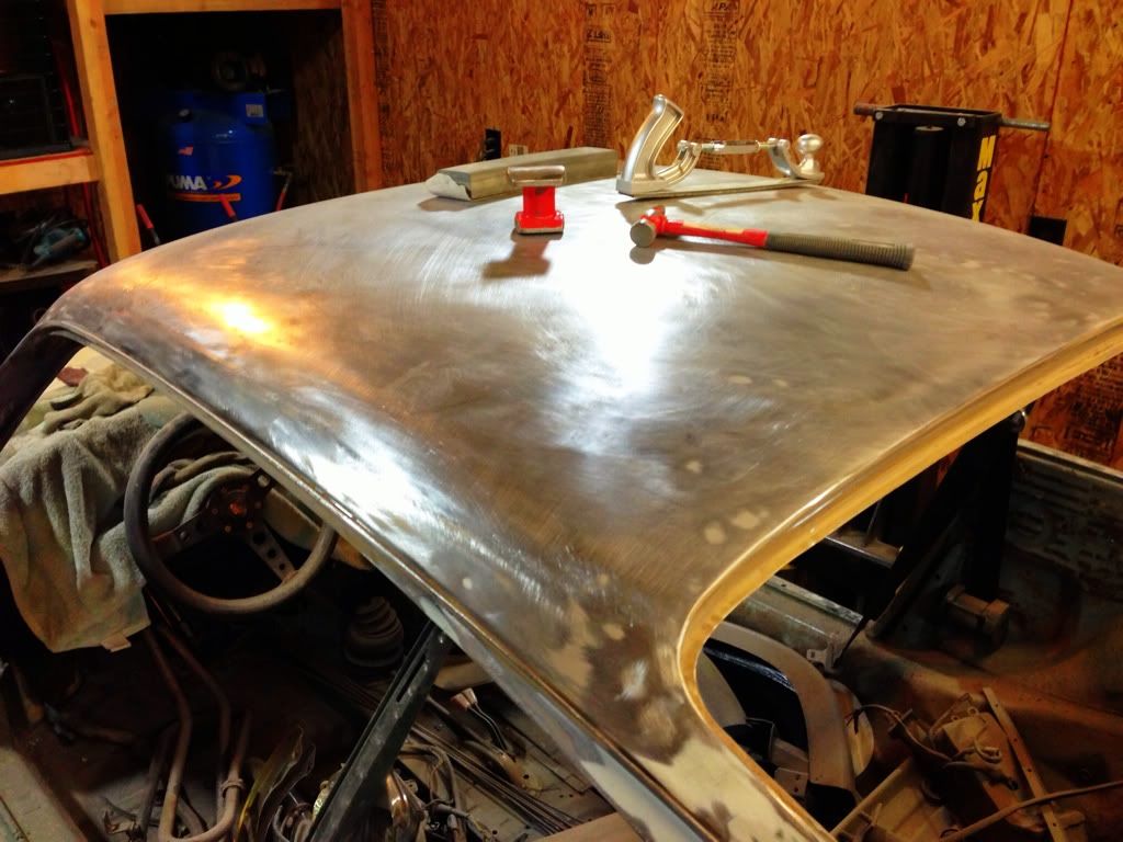

Sorry about the lack of posts... Block sanding is one of those things...LOTS of work but really very little to show for and not very interesting to take pics of. I was able to strip most if the car down to its original primer and zinc coating but since the roof was off an older car, I opted to strip it to bare metal. The roof sat in a shop in San Fran for a while with stuff stacked on it so I had to use the "pick and file" technique to correct most of the dents. Sheesh, you can spend hours doing this!
I'm hoping to get the bulk of the car in primer before the end of the weekend. I need the lift for a motor swap on another car so this one needs to get out of the work shop.

Originally Posted by davidcz... View Post
Question about painting engine bay and trunk areas, do you pull the wire loom out to spray, or just mask it?
I sprayed the big areas but otherwise you can use a brush or those little pinky rollers from Home Depot. Those work great for the large flat areas like the bottom of the floor pan. Spraying upside down is nearly impossible! With the undercoating as a substrate, you will not see any brush or roller strokes, MUCH better than a bunch of overspray all over the wires!

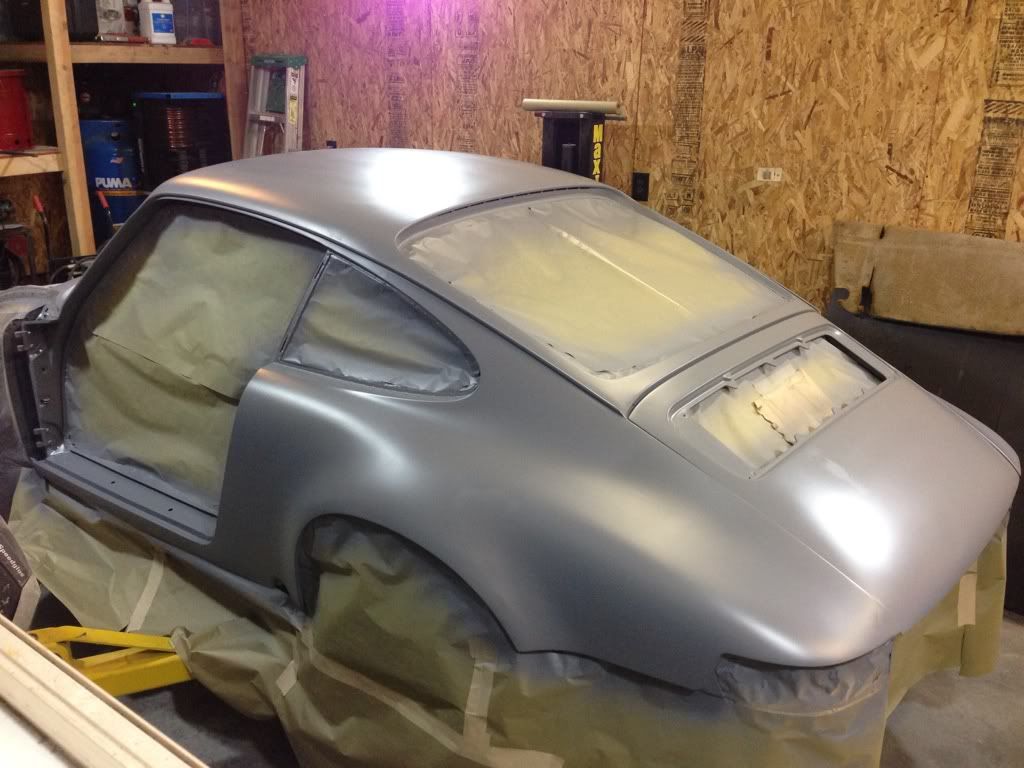

Lots and lots of sanding later................... I've come to the conclusion that there isn't an easy way to strip a car. DA, media blast, chemical strip...they are all a big PITA!
Although, I finally made some notable progress today. The chassis is in primer!!! Three coats of DP40 epoxy primer and 3 coats of high build sandable primer. The body seems very straight so block sanding should be pretty quick...did I just jinx myself?
More sanding...
DP epoxy primer...

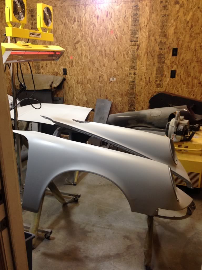

High build sandable primer... Also note my new heat lamp. This dramatically speeds up the drying time of any paint product. For instance, the primer usually takes 8 hours to cure...with this, 30 minutes!

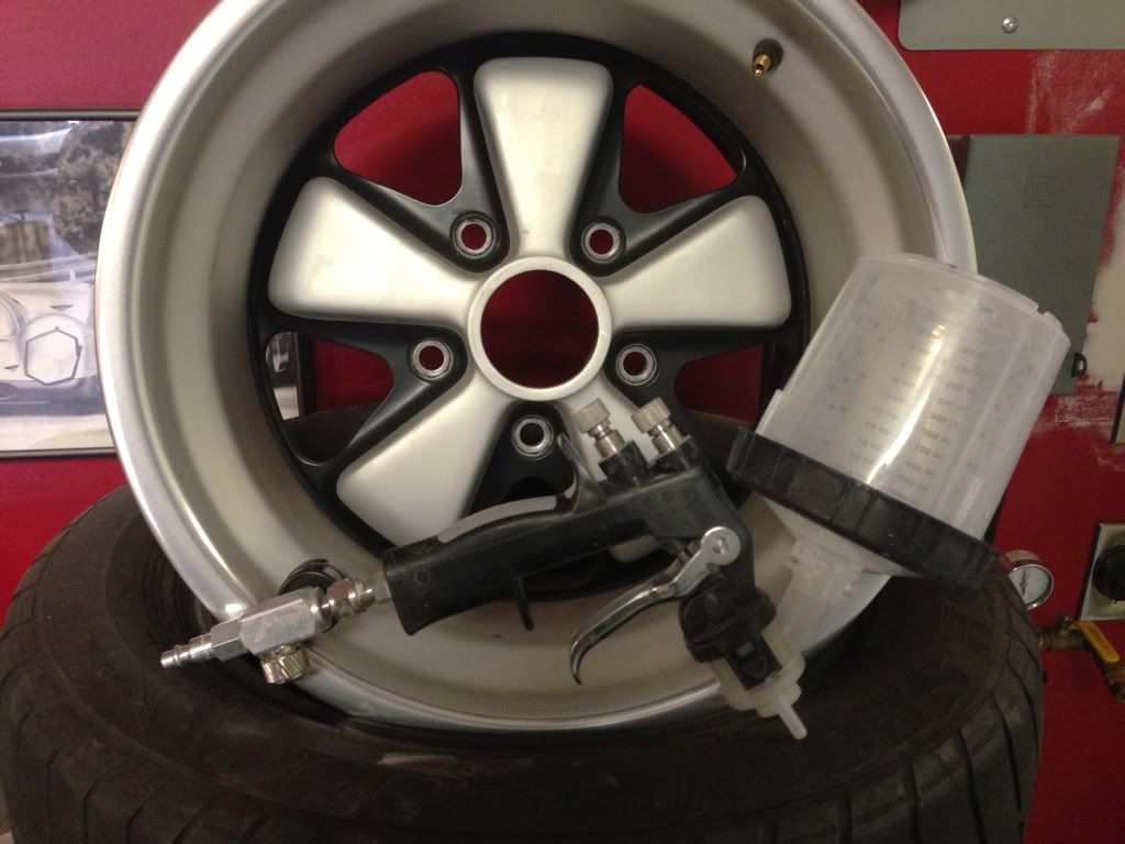

New toy... This is the 3M primer gun that uses the new PPS system. Wow, great primer gun! And the clean up with the PPS system is incredibly fast and efficient. They use disposable liners in the cup that form a vacuum seal with the air so you can spray upside down. Love it! Now I need to buy an adapter so I can use these cups on my paint gun.
