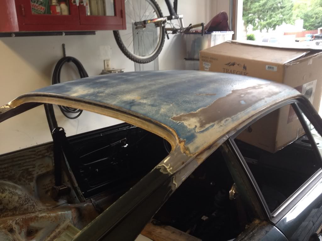

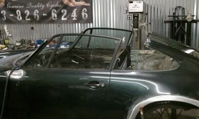

First item on the check list was the roof. The previous welding was beyond repar so I went back and forth...sclap it or just cut its head off?!?!
Utimately, it was a quicker option to cut it at the pillars and drop on a whole new roof, well, an old one from a 68 911 that was beyond repair.
I think photos will tell a lot more than words here. We left the door frames on for reference and took A LOT of measurements!
We were even careful to build a bracing system out of welding rod :-)

The pillars have internal metal which would be impossible to weld so we opted to build sleeves inside the pillars for added strenght.
And finally the roof fitted and welded on.
