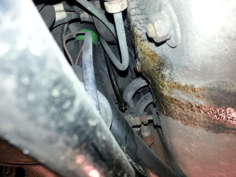

Posts: 1,150
I had the same problem when I replaced pads and restored rear calipers. I think your problem is the brake line on the top of the master cylinder (this is if you have car of the same vintage as mine with the MC next to the steering rack under the car). After you remove the skid plate, several brake lines need to be bled. The one that is really hard to reach, the top one, seems to be the culprit. Crack that one and bleed the brakes again. I was amazed how much air came out of that fitting. It carries fluid to the rear of the car if I remember correctly. Because the line goes up and then down again in a loop, air is trapped at that spot. Keep at it. Eventually you will get the air out of the lines.
He is talking about this one behind the stone guard:
