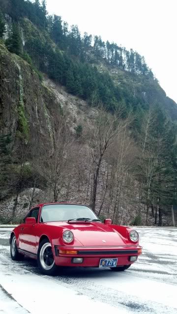

I just got an SC for my daily driver. I got a chance to try it in the snow here in Denver and it did ok. Looking into a set of snow tires. I sure do love the thing though!
