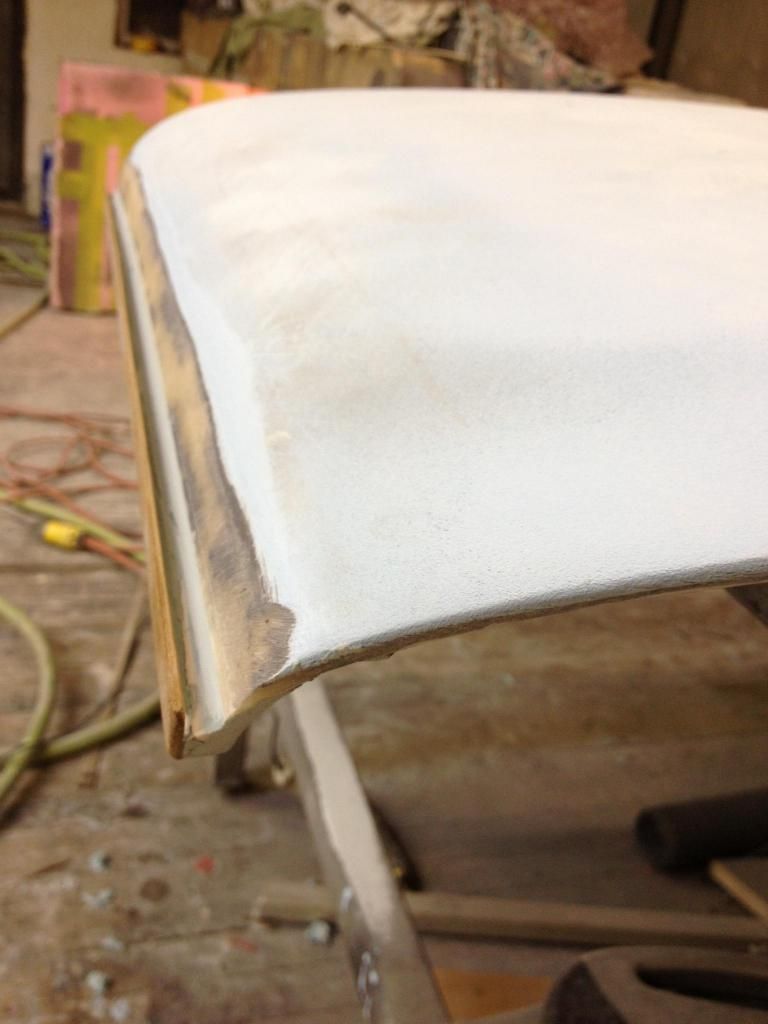

toddc 01-31-2013 05:21 PM
You guys are killin me with the led lights and the alcantara linings, etc. :)
We're still developing the surface and trying to decide on a mounting scheme but it looks like we will be able to develop an inner frame that supports multiple vintages.
While we continue to make some progress, please enjoy the following pics of a proper rain gutter being developed.
I took the wide, fat ledge that was shown in my previous post and refined it into something that I think looks the part. More development to come.
btw, don't worry about the sags in the fairing compound, it sands like butter....
Thanks,
--toddhttp://forums.pelicanparts.com/uploa...1359685023.jpg
http://forums.pelicanparts.com/uploa...1359685052.jpg
http://forums.pelicanparts.com/uploa...1359685071.jpg
http://forums.pelicanparts.com/uploa...1359685096.jpg
http://forums.pelicanparts.com/uploa...1359685118.jpg
http://forums.pelicanparts.com/uploa...1359685139.jpg
http://forums.pelicanparts.com/uploa...1359685179.jpg

nineball 02-01-2013 03:16 PM
for those who were asking here is a shot of the rain gutters bonded before the fairing compound was applied.
http://i15.photobucket.com/albums/a3.../IMG_0288.jpeg
