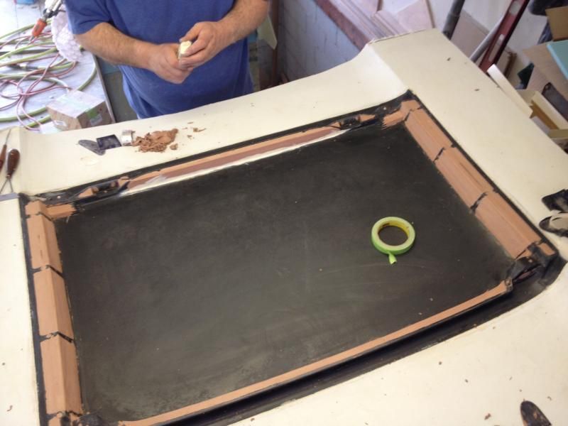

nineball 04-06-2013 02:34 PM
top mold is done and the underside is being clay modeled as we speak.
http://i15.photobucket.com/albums/a3.../IMG_0465.jpeg
not only will we have the top but we are also reproducing the escutcheon plates, rear guide pins and an alternative to the side seals that will not require a metal plate and screws be installed. this really will be a plug-and-play item, and for those of you wanting to do some restoration work on folding tops we will have the above parts available at some point in the future (we modeled the rear guide pins from the set on my folding top).

toddc 04-06-2013 06:10 PM
clay modeling finished, model prepped, tooling gel applied.
All in a days work. or so :)
Next comes the layup of the mold itself. wish us luck;)
