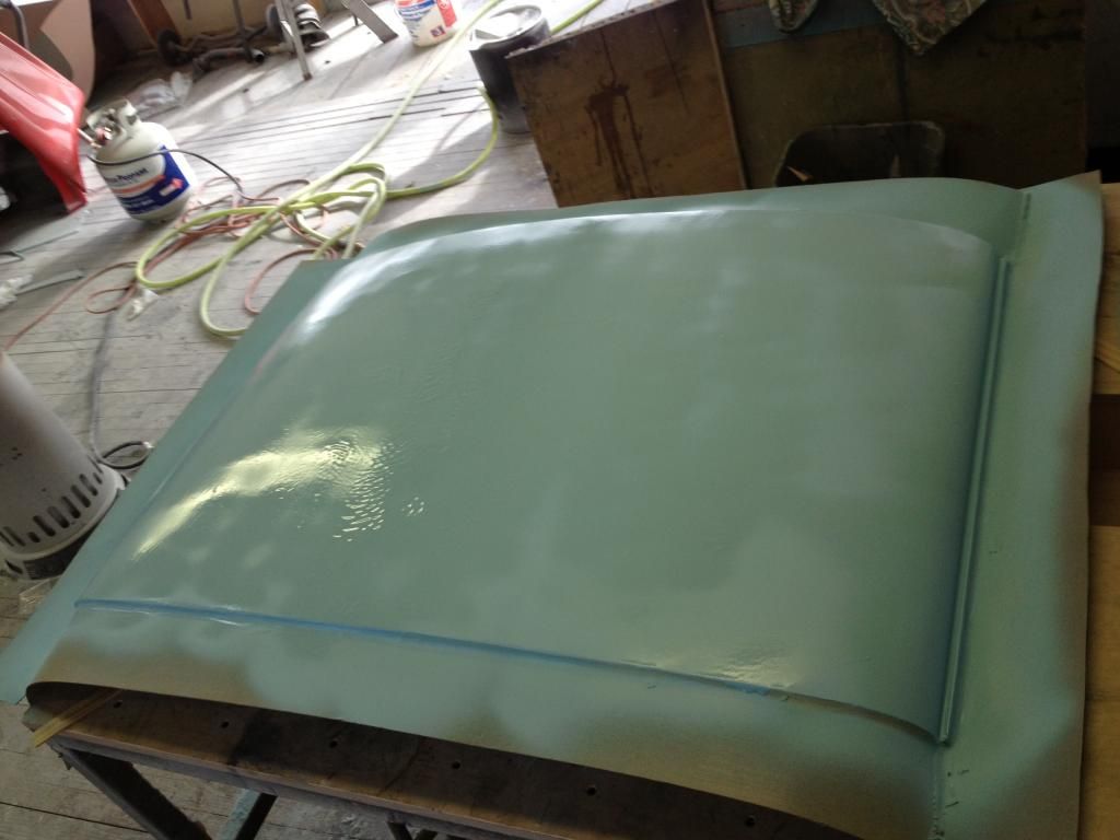

I figured it was time to give you guys an update.
Yesterday the last coat of fairing primer was applied and let to cure. Over the next couple of days we'll have it slicked out and will begin building a proto skin mold. The skin coming out of that mold will be used to mock up the frame.

top has been flanged, sealed, gel coat applied and we are just about ready to make the mold.
http://i15.photobucket.com/albums/a3.../IMG_0336.jpeg

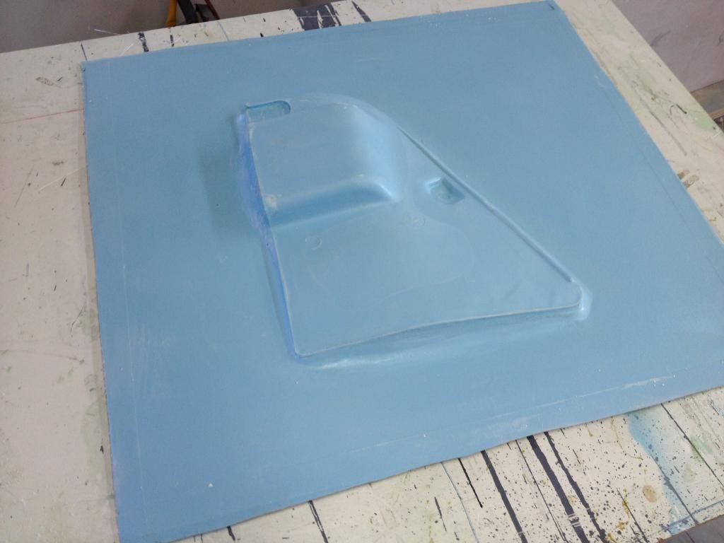

we are also starting to work on making rear fuse panel covers since they seem to be an item most people want. here is the part getting ready to be molded.
http://i15.photobucket.com/albums/a3.../IMG_0334.jpeg

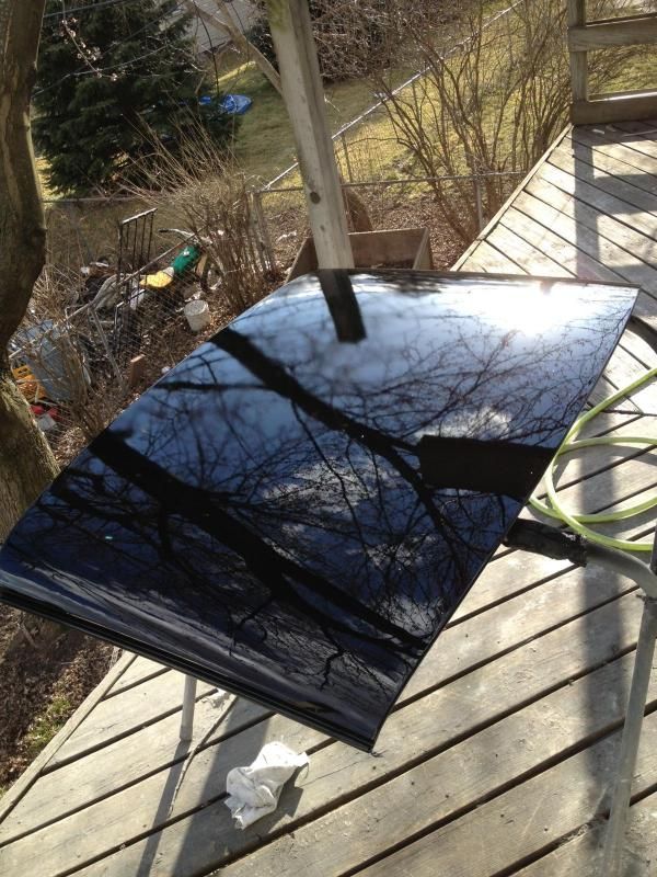

nineball 03-01-2013 10:31 AM
update! progress has been made and here is the first outer skin fresh out of the mold.
http://i15.photobucket.com/albums/a3...n/IMG_0358.jpg

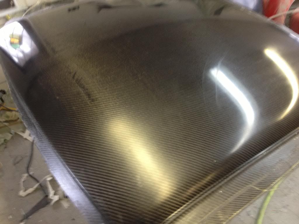

tdw28210 03-02-2013 07:11 AM
Carbon Fibre Pattern
Toodc and Nineball,
Nice work! What pattern in the CF for the targa tops? So of us may want to match it with body vinyl wraps.
angelny911 03-02-2013 11:01 AM
chime
toddc 03-02-2013 02:11 PM
pattern is 2x2 twill....
