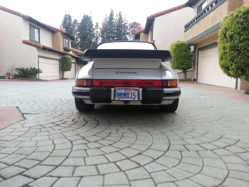

Hi Jim... They really do look good! - I ( and others I'm sure) would like to see those big boots of yours from the rear. When it's day light, how about a photo from the centre rear?.
Here you go with 245's in the rear:
http://img.photobucket.com/albums/v5...ps76d57765.jpg
http://img.photobucket.com/albums/v5...ps0d354f1c.jpg
A horse with no name 03-22-2013 12:17 AM
Very Nice Jim... I looks very tough! -I'm not a biased pro street guy - All lies. :)
What's next?- Maybe just a good break for a change ay.

man, I got the wheels for looks but the performance is a big bonus, I am so happy, she is quicker off the line through out the rpm range.

LOL! Yeah got to take it down a bit in the back and bring it up in the front. Hopefully the weather will cooperate this weekend, since winter still hanging around here.
