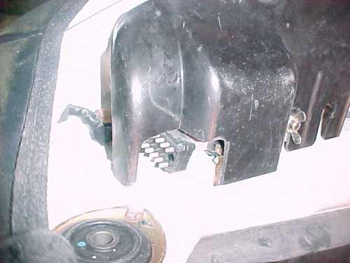

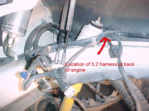

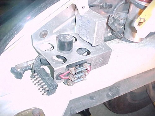

Marcesq ........here's the JPEGS I promised.
Make sure you can get to, and secure that fuel return hose. I check it everytime I adjust the valves.
Accumulator removed from fuel supply.............
Hope this fills in the gaps for you. What are you going use for an oil cooler ? Did you find the AN lines you needed ?

Cary:
Your timing is unbelievable . . . see my post of minutes ago.
Can you post a pic of the hole for the DME harness.
I think I found the hose in Washington. 5.00/foot and they will install crimped -12 AN fittings on the four ends that attach to the Oil Stat, leaving 4 re-usable ends for me to attach once the hose is trimmed to fit.
Thanks . . . you are the man.

Opps..........forgot one.........
