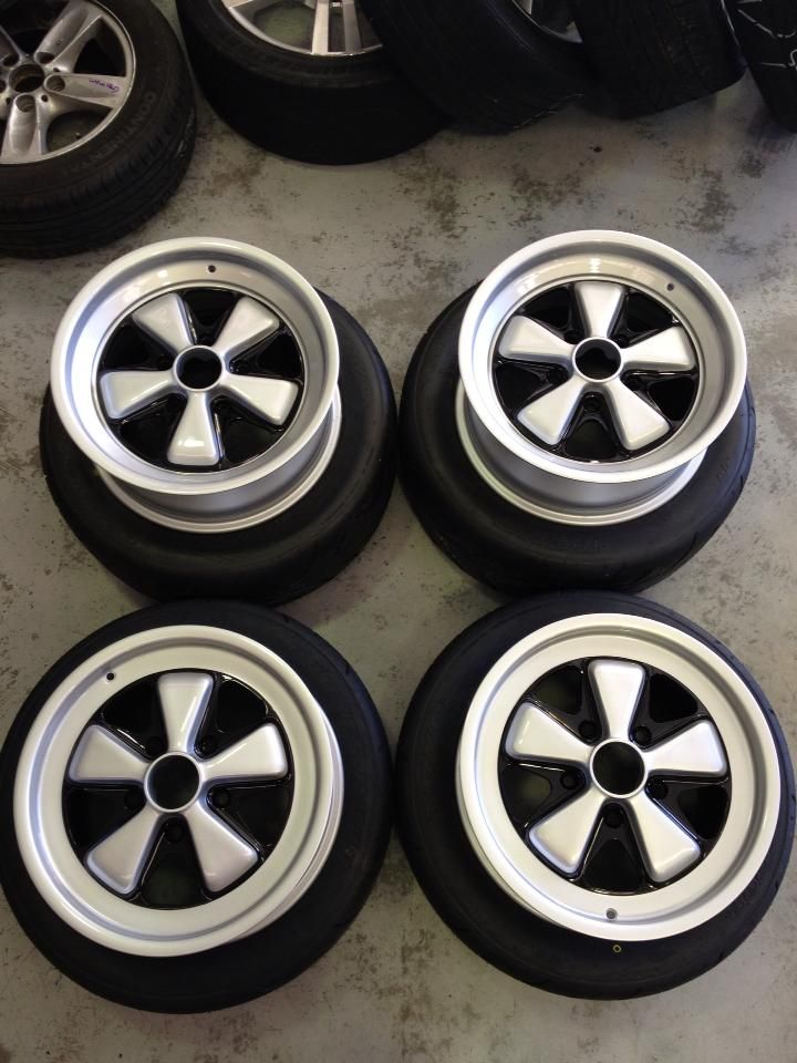

After looking at a few threads on here I got mine done.
Not that happy with how they turned out but there ok.
Definitely look good on darker colored cars.

Finished set
Here is the end result of the set.
