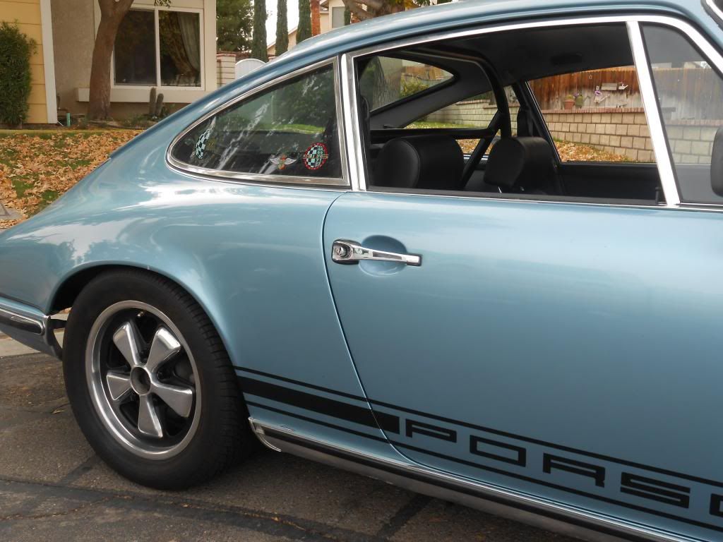

Finally got the nerve
I'm actually pretty proud of myself
mask, 3m scratch pad, quarters in the lug holes, spray with SprayMax 2k primer, paint with REM Trim Black, wala!

Nice job, your car looks great and the wheels just right.

I started redoing my wheels today using rattle cans. I used the paint (Metallic Matte Nickel #7277) for the pedals suggested by manichols. It appears a bit too dark. Any other suggestions? Lastly, is a clear coat or two recommended? Thanks, Gary

Robingb - did you use any type of primer? I used a light self etching primer to prep my wheels, from which the Matte Nickel shows up fairly light. Just a thought.

thanks for the reply. i used a light green self etch primer. after a few coats of paint i don't think a lighter primer would have had much influence. i will paint the black tomorrow. maybe it will make the pedals look lighter. did you finish with a clear coat? if so, was it a matte clear or a gloss clear?

Maybe someone with more knowledge on RS wheels than me (because I have none) can chime in but I don't think a clear coat is used. As far as primer, I used a two stage spray primer with the activation button on the bottom of the can to activate the epoxy into the primer. Worked great. Four months without a chip.

Rustoleum 7271 Brilliant Silver.
A few examples and discussion here:

I recently purchased some 8x16 from a Pelicanite and decided that now was the time to clean up my wheels and finish them off with an RSR finish...
Well, many weeks later and some frustration because I am sorta-anal, I decided to leave them as per the pictures below. I ended up redoing them several times because of rattle can paint color choices.
I ended up Scotch-Briting the lip, other than that, the petals are of a satin silver finish.

Looks good. What paint did you use for the faux anodized?

I think he just used a Scotch Bright pad. And then painted the centres black.
They look great!
