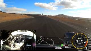

Here is my best lap to date (a 1:27.04), with the start/stop set at the cone at turn 9 of Willow:
A set of slicks would probably do it -- but I'd rather earn it the old fashioned (and less expensive) way. My primary new weapon is the change from Bilstein Sports in back to adjustable Öhlins shocks, customized for me by Wevo. So far, they haven't gotten me back into the :27's, but ambient temperature is very important for my car at Willow -- I need all the power I can get -- and it was something like 34° when I ran the 1:27.04.
So, I'd love to hear input from people who might be able to offer useful advice. It could be that I should be slowing down a little bit more at the slow part of some of these corners (like the faster guys), although it might also be that I'd need their horsepower to make that worthwhile.
I continue to play aorund with ride height, ARB settings and shock settings. I've gotten the car so it doesn't push as much as it used to. I've gotten better parity between front and rear tire temps. I've added some front and side skirts to improve my aero.
But I think for that last second, I'm going to need all of that and more. So I'm throwing the question out to anyone who's interested.
Where's my 1.05 seconds?

I would look at his exit speed at turn 9. My guess is he is getting onto the power a little sooner. I know your apex speed is faster but it could hinder when you can get back on the throttle.
I did not look at the data but this looks like the obvious section to gain time. 9 to 1 and 5 to 6 look key. How much throttle do you use through 5 to 6 exit ?

I'm full on the throttle from pretty early in 5. But I agree with you about turn 9. The reason the clipped lap is timed from 9 to 9 is because I accidentally went through 9 much quicker than usual (about 4 mph more) and it got me a full half second on that lap, even though I didn't carry the same speed at the very end of the lap as I came back to 9.
Also, I've compared my laps to other similarly-timed laps and I have to conclude that I'm a little slow through 9. I think I could go even faster than I did in that fast lap. The only problem is that the price of blowing 9 is high. It's a bad place to go off:
But it's one of the big areas I'm going to be working on. Thanks.

Jack, I respectfully suggest that you make two changes to the driving line in your above diagram.
1. Exit of Turn 2. Don't try to pull your car inside, as pictured, stay outside a little, and let it float out toward the left side of the track. Yes, it's blind there (small crest), and there might be some marbles, but trust that the track is there. Make sure the surface is clean before you do this at speed, and be sure to know where your car will straighten out. I used to reel in cars at that point of track, and pass under braking going into 3.
2. Experiment with the area between 4 and 5, an earlier apex, than the diagram shows, for 5 will get you more speed into 8 (I know, you'll touch the rev limiter sooner!). This, 4, is a very tricky turn, almost to the point that you don't want to over-hurry the car coming out of 4. No need to slide the car, just get it set for 5, and you'll carry more speed all the way to 9.
Let me know what you think!

Thanks, Peter. Do you mean wider as in missing a little more of the late apex in 2, or tracking out more after that apex? I think the line in the graphic goes wider than I do if you're talking about the 'track out' after 2. I am flat on the throttle at that point, and I usually only drift out as far as I have to.
But if you mean missing the apex by a little more, then that's interesting. I know I've had some fast laps where I'm noticeably off the apex, and I've never known if that was a plus or a minus.
I've played around a lot with 4. I know my 'all the way to the top' line is unconventional. But in going for the usual compromise line, my car has always been slower. I reel people in pretty effectively on the downhill from 4 to 5. And I consciously turn in early for 5 -- but gauging the best speed there is a trick. That stretch of pavement seems to change more than any other segment of WSIR, in terms of grip.
Thanks, Zulu. The last time I was there, I was aiming in that direction. I belive the front and side skirts will help slightly with drag, as they keep turbulent air from getting down underneath me. I also made some larger endcaps -- which will make the wing more effective at a lower angle of attack. One of them started to come loose, though, so I went back to the small ones and the maximum AOA on the wing. But I'll have that fixed by next time and it might get me something.
I'm also thinking about ditching the canards. They made a noticeable improvement in terms of planting the front end when I put them in, but I know they come with a high price when it comes to drag.

Yes, staying wide through the exit of 2 seems to help. There is a "groove" in the track at that point, almost like the pavement has a slight bank, that really holds our cars - this might be completely different in a small open-wheeled car. I, at one point, followed the recommended line, but always had the nagging sensation that I was forcing the car to get there, or that I was going too slow. Once I started leaving the car about two car-widths wide outside of that recommended line (at the point in the diagram where the white line appears to go to the inside edge of the track), and letting the car go over the slight rise further to the outside, I was much happier at how the car felt under me. For a while I didn't realize there was as much track available on the outside, at the exit, as there is, but quickly discovered that not all of it can be used - you don't want to get outside too soon!

Here's another side by side clip I've put together. This is me next to a guy who is impossibly faster than me. It's James Sofronas in the WC Spec Audi R8 that ran a 1:19 at Willow. But the gap vetween us is not so great in turns 3 and 4. The interesting thing in the clip is the freeze-frames with speed comparisons. I wish I understood more about suspension and cornering, but there are small sections of the corners where I carry more speed than him -- and many sections where he is MUCH faster than me. (Disclaimer: grabbing video isn't very precise.)
Here's the clip:
