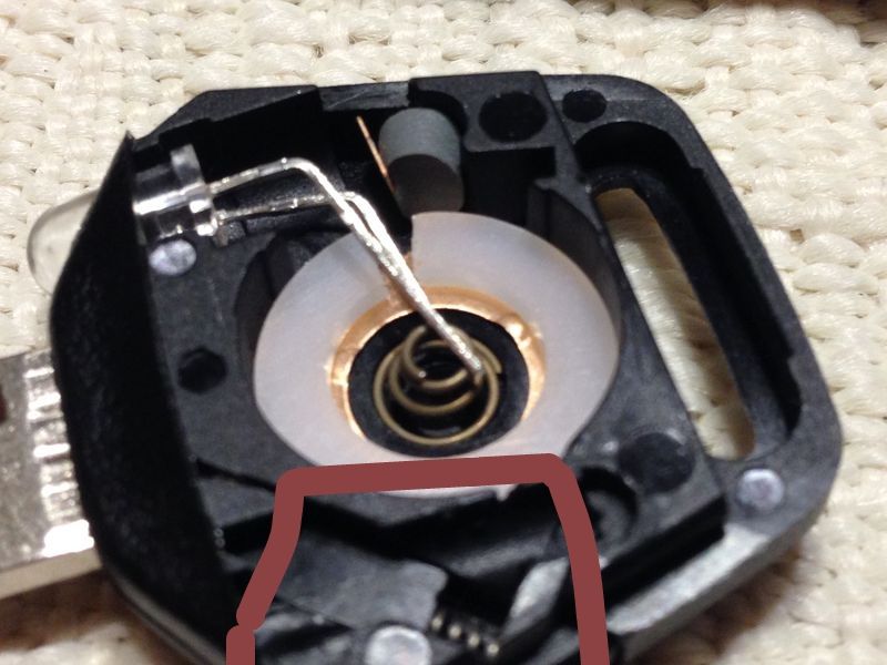

Thanks. Anyone know how to get the key itself (the metal part) out. Bought a new key head and cant seem to get the key out. Thanks
Old 05-28-2014, 03:34 PM
964TargaC2's Avatar
Join Date: Nov 2010
Location: Missouri
Posts: 2,186
See photo below, the metal key is notched and the spring loaded plastic piece at the bottom of the pic holds it in ...either push the plastic piece back and pull key out or remove spring and push plastic piece back to release key from head
