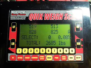

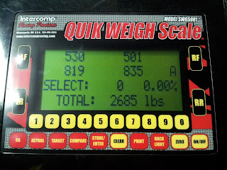

Old 01-17-2014, 01:01 AM
Join Date: May 2012
Location: Troy, Mi
Posts: 1,937
I borrowed a set of scales and did my own. I got pretty lucky when I bolted my car back together and was close, but a little fine tuning never hurts.
Before and after shots below. Photos are of without me in the car, but the cross percentages didn't change significantly with me in there.
For a street car, you would have to be pretty far off to notice a difference. For a track or competition car, it's worthwhile to do because it gives you more consistent behavior in turns.
