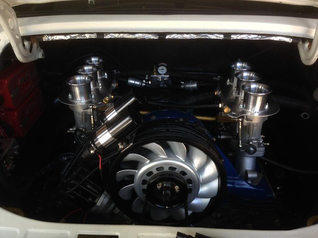

It's a 3.6, but I'm glad my disguise is working!

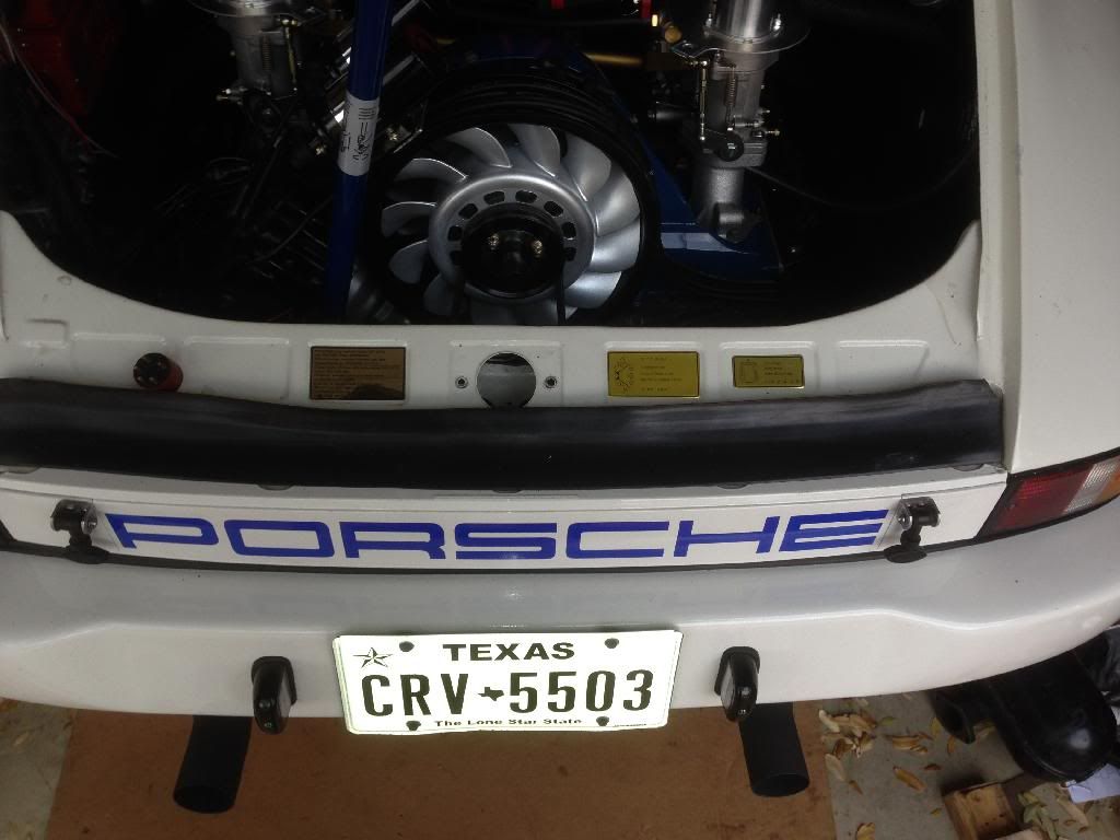

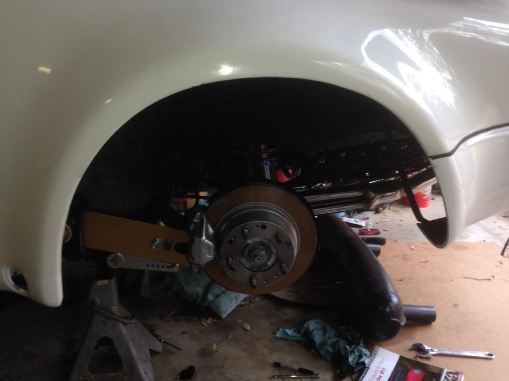

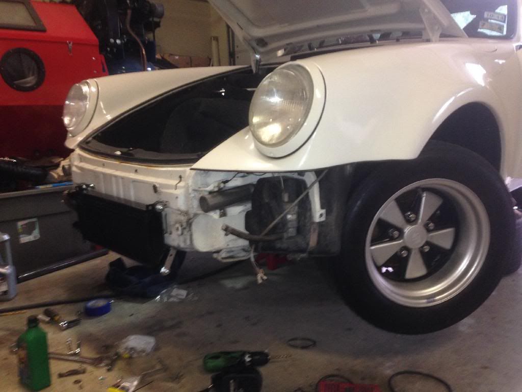

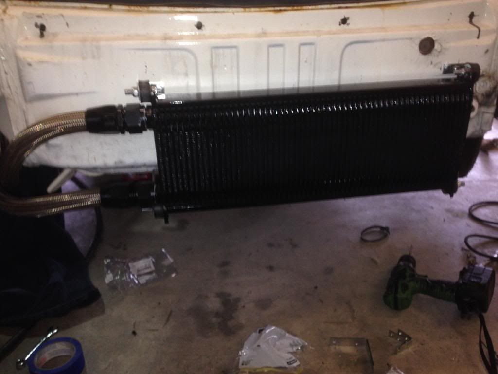

Got the front oil cooler installed. I was going to notch the area behind it for better air flow, but I've never had an issue with my other car, so if it gets hot I'll do it later. I also finished up a few open issues on the rear suspension and bumper. I also determined that my Dansk 2in/2out banana muffler won't fit, so I order some parts from Summit to fab up a new set up. Here's a few pics:

NICE what did you do to mod the engine shroud .

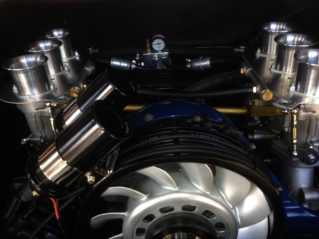

I can't believe the f'ed up wiring in this car! So far I've pulled cut up extension cords, 4 conductor telephone cable, and speaker wire used to wire critical components.
However, I added oil to the engine, tightened up the last few connectors, and bolted the seat back in. I also tested the new wiring and all seems ready for first start!
My muffler, mandrel bends, and flanges should be here Wednesday. All that's left is to weld up a new exhaust and drive off into the sunset...
...well, there is a couple hours of tuning, shake down, fixing what ever little issues pop up. Of course, all this depends on the used 3.6 that I bought not having any internal issues...
Engine looks cool!

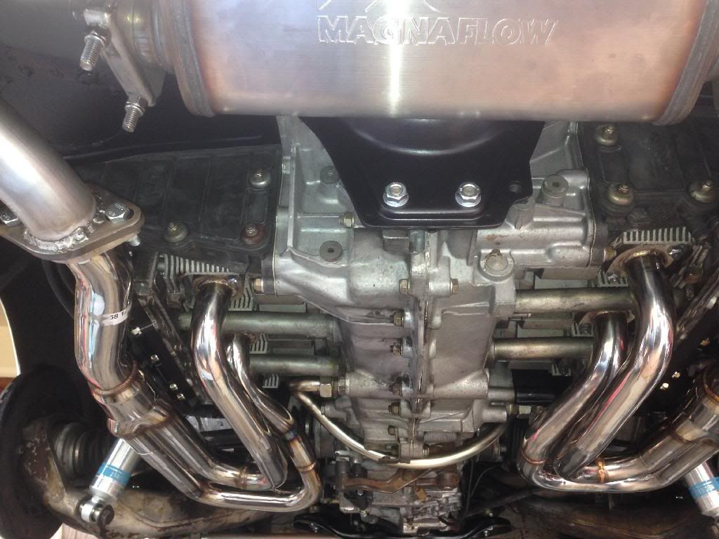

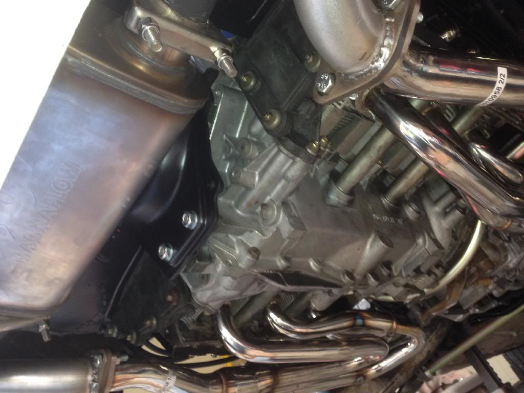

My magnaflow muffler and a bunch of mandrel bends from Summit showed up yesterday, so I spent today measuring, cutting, and welding up my exhaust system. Tomorrow is first start!

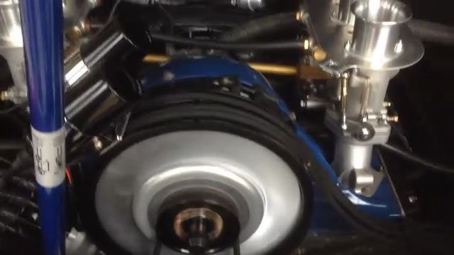

Victory is mine! This thing sounds badass and it is the perfect sound level. A nice rumble, but no drone or resonance. Just perfect!
The front oil cooler is leaking, but I almost don't care. Everything else is perfect and I'll fix it later this week.
Oh yeah, tap the picture for the video.
"Too much is just enough."

It took four tries. Wasn't getting enough fuel, so I opened the mixture another half turn. Then advanced the timing a bit. She coughed and roared to life. An hour of carb balancing and turning and she sounds purdy!

What muffler parts did you get from Summit?
