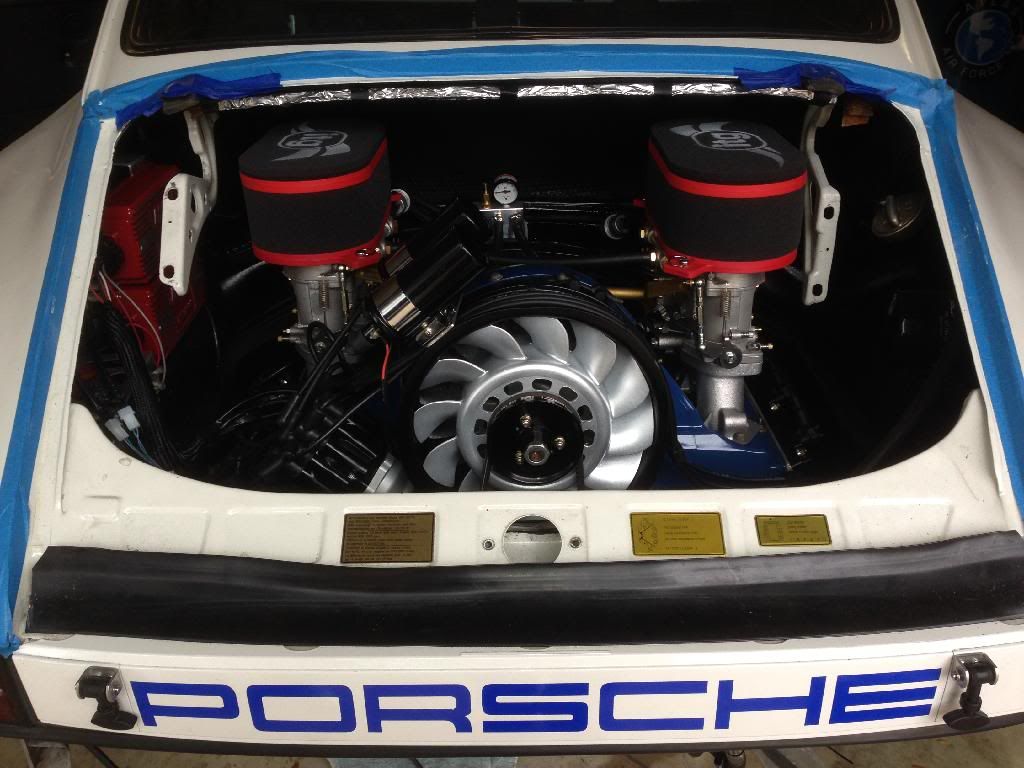

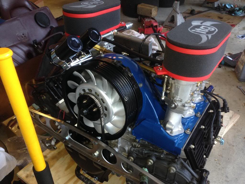

I figured out the wiring. Dennis was right, a PO wired one of the relays in the engine panel to power the fuel pump. Once I got all the tape removed I was able to ring all the wires and move several positions in the engine harness plug to match the chassis harness. I also added the air filters:
I little more wiring work and some mods to the engine electrical panel to mount the MSDs and this bad boy gets installed!

Are those blaster coils? Where are the boxes going?

They are blaster coils and the boxes are going where the old box, accumulator, and fuel filter used to go. Pictures this weekend.

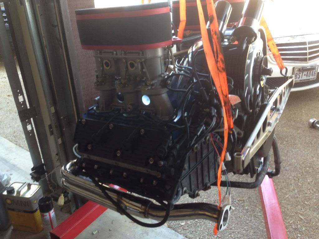

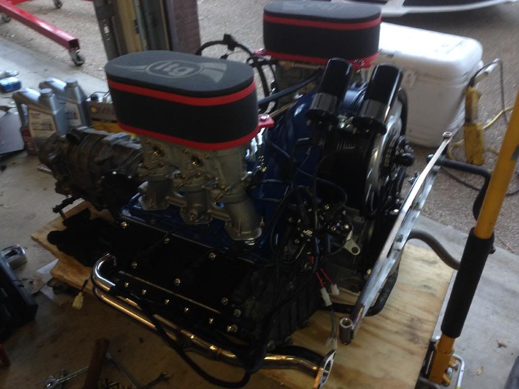

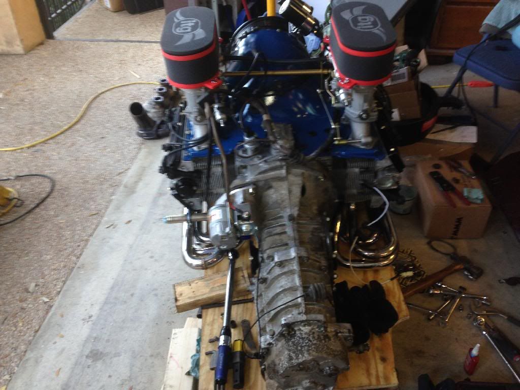

Got a lot done today!
This would have been entertaining to watch. I had to remove the stock exhaust while the engine was dangling from the hoist. What a pain!!!
Everything else went pretty well. I grit blasted all the tin and got it painted. Going back on tomorrow. Installed the flywheel, clutch, and tranny. Tried to bolt on the starter, but the studs are too long for the barrel nuts. Off to the store tomorrow. It's really starting to look good!

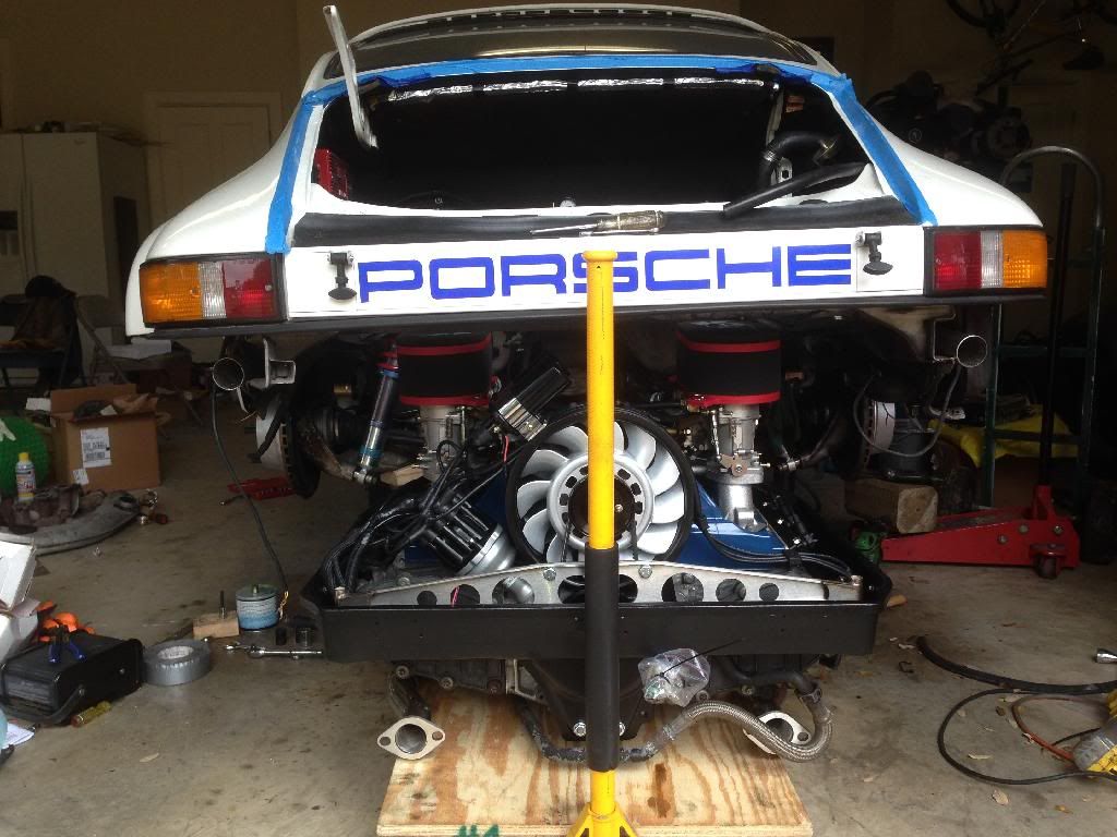

Old 02-15-2014, 03:48 PM
non-whiner
mreid's Avatar
Join Date: Aug 2012
Posts: 5,235

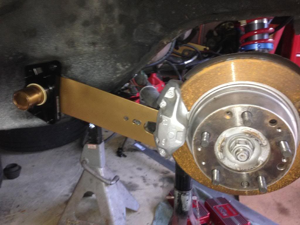

Engine is going in next weekend! I ground out the old sway bar brackets and welded in the new ones, cleaned and painted the spring plates, installed he Rebel Racing bushings and coilovers, and finished the engine wiring and MSD harness. All in all, a productive weekend!
Once the engine is in, I still have to install the front oil cooler, but at least I move to the front.

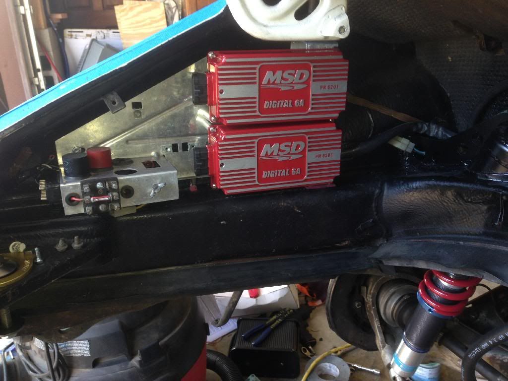

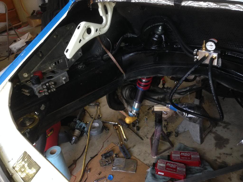

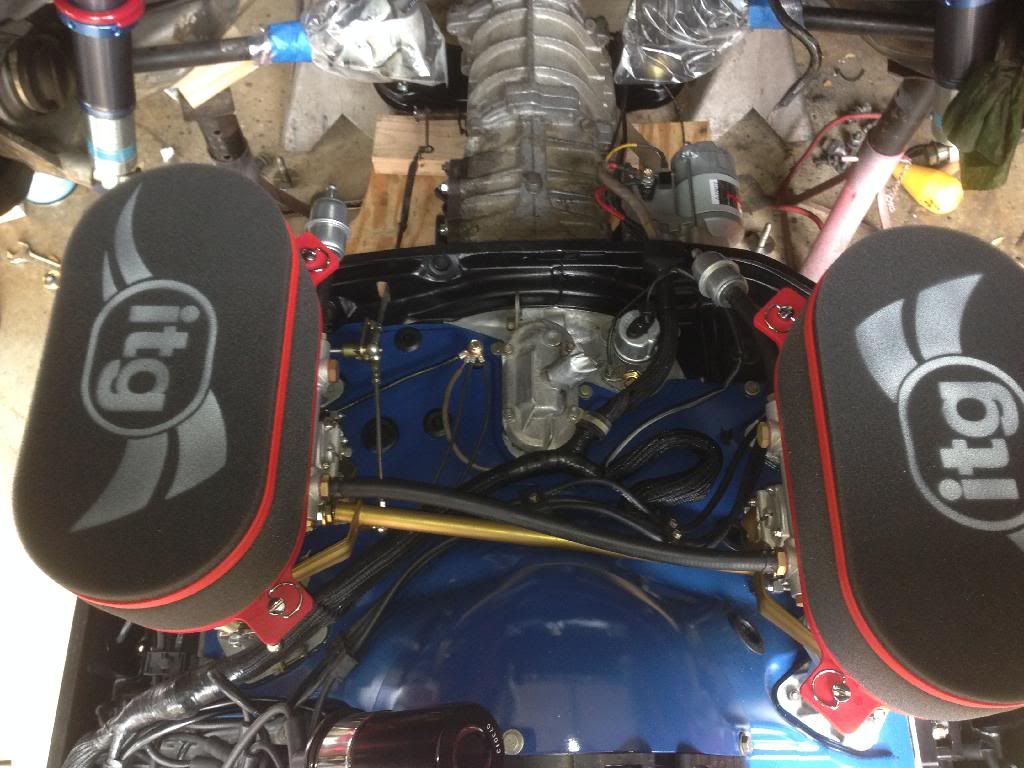

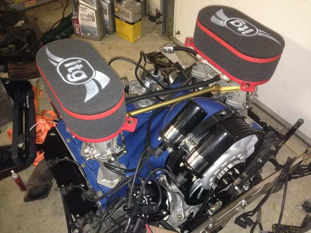

MSD boxes installed and wired:
I'm now going to attempt to pull the mechanical speedo cable with the wires for the electronic version attached for one easy remove/install. Fingers crossed!

In your picture of the MSD boxes, what is the silver annular ring on the outer half-shaft end, between the bolt heads and the boot retainer?
