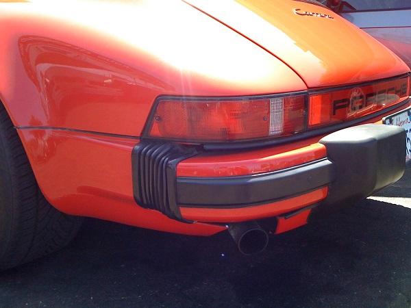

good job .......but remember this...anybody hit you from behind in traffic your body parts will be pretty much kaput...i got hit in LA by a pothead in Prius the whole front of the toyota was gone but my 911 nada,just had to realign the rear bumper....so be careful and watch for tailgaters;-)...

useless weight? Really!!! Must be a joke.

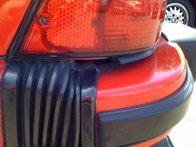

Every euro car has the deformable tubes instead of the hydraulic rams. That makes about half the production in those years

flashboarder's Avatar
Join Date: Aug 2017
Location: The Netherlands
Posts: 62
got it now, you replaced hydraulic with deformable while I thought you just removed! My mistake, sorry!
