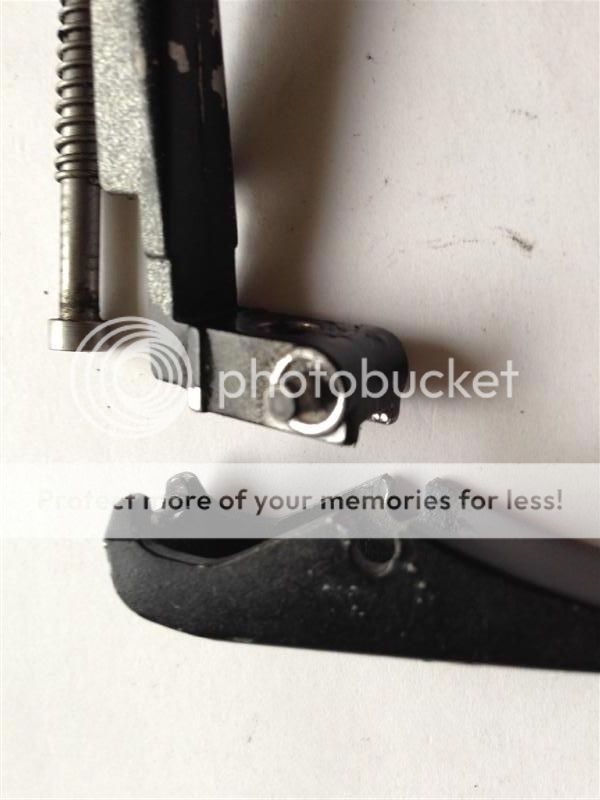

Having some problems with my Drivers door exterior handle. Seems the plunger that extends is not pushing far enough to release the mechanism to open the door. I was in there and bent the inside lever a while back. Anyone else have that issue? I may pull the inside lock and weld a spacer on it or try and make another offset bend unless there is something else going on ? It opens great from the inside. LMK if there is a some known wear issue on handle mech I am not aware of , before I mod the inside lever.

I had a similar problem. I tried the same things you have. It turned out the trigger of the door handle developed a crack and was not pushing the pin enough. If this is the case, the trigger cannot be bought separate from the handle. You would need to buy a complete handle.

I am suspecting the Pivot pin area cracking Ed mentions. I just went to the garage and realized the pawl lever was in a semi depressed position and pushing it back like where it would be for a full strole make an odd feeling as if the pin had migrated into the crack.
madmmac's post with the alumimum levers looks interesting, I'll tear my handle down and evaluate. I suspect I will be opening up Solid Works and getting the mill fired up, see if I can simplify the work done on the alum copy... Back at you later.

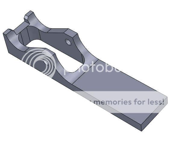

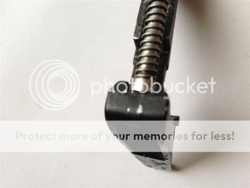

The pivot hole was cracked on my trigger lever.
I went ahead and started making one out of steel and simplified some of the geometry so I could make it easily on my manual mill.
Initial cuts ( I bent the finger curve area at this step just didn't model it.)
Final finish radii and trim cuts. ( finger bend not shown)
and OOPS forgot to add the back chamfer cut on my model/print if anyone is paying attention.

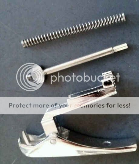

I saw this reproduction lever offered, ( for only $28 on ebay) but oddly the actuator pin looks different than mine and looks to be cheap pot metal.
Mine (74) is just has one stepped up diameter on the lever end and no rectangular block. the lever acta directly on the face end of the pin.

if the trigger isn't broken, the pad on the latch that the trigger pin pushes on is likely bending inward. usually the latch is so worn at this point that you need a new one.
one trick i do for more pin length is to drill out the threads on a camshaft timing pin and slip it onto the trigger pin.
