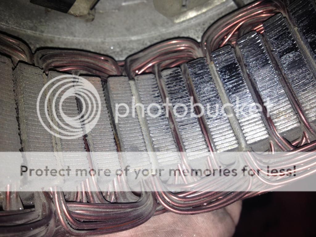

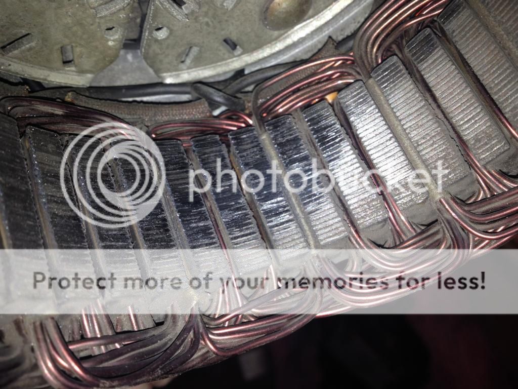

Here is where the stator looks possibly damaged. One half of the ring looks polished and/or scraped. here's one edge of the area:
here's the other side of the area:
see the metal shavings magnetically attached and protruding from the rotor? is this expected??? is this metal from the stator ring?

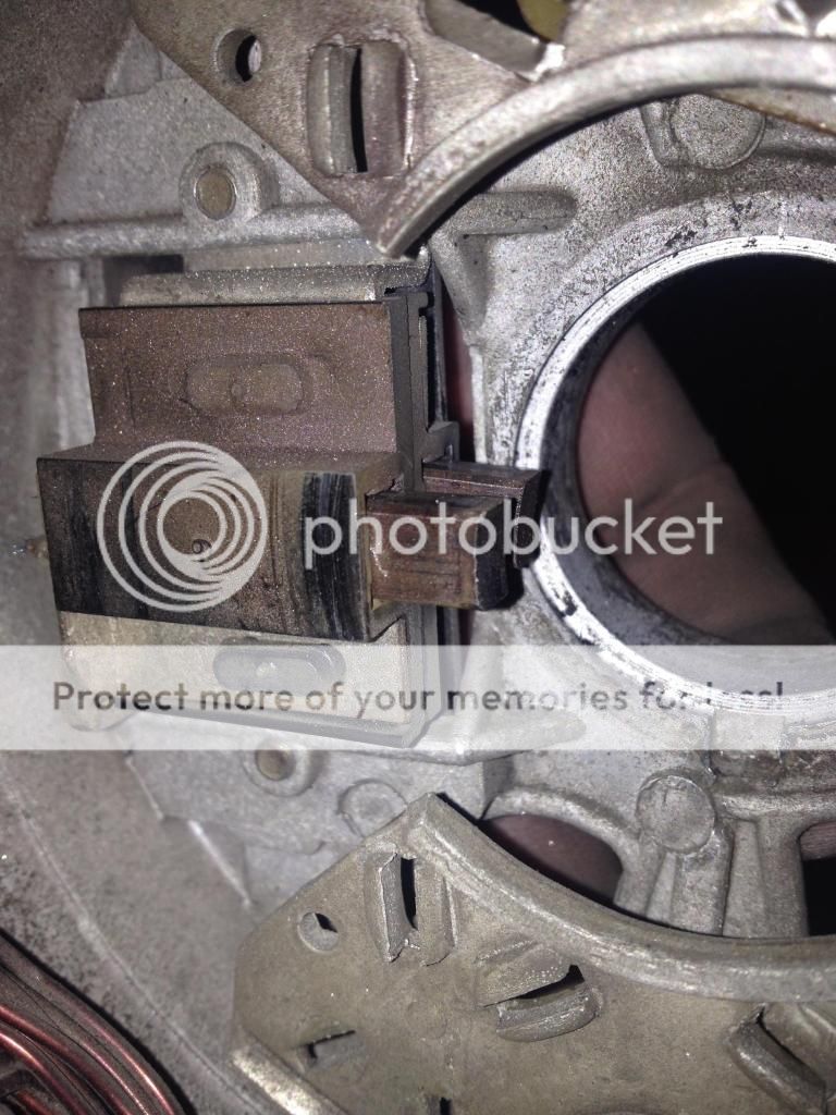

brushes seem ok, possibly ~50% remaining (?):

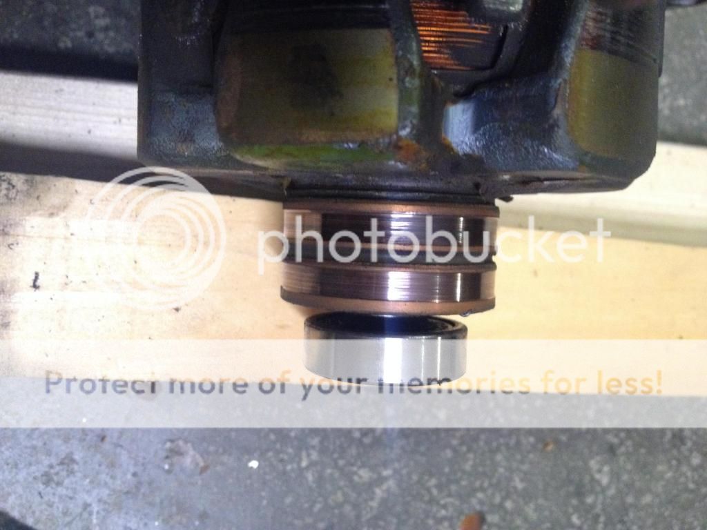

Minor grooves on the contact rings:

The alternator stator has 'shorted' windings the result of the rotor 'dragging'.
It needs the stator rewound. That alternator (SEV Marchal) was the most
reliable alternator with the external regulator used in pre-1990 911s.

A simple ohmmeter test from the windings to the stator core will indicate a short
if the stator is bad. When the rotor 'drags' on the stator, it causes the stator laments
to move and touch the windings causing a shorted winding to stator.

The rubbing between the two parts looks to me to be cosmetic in the pictures.
Looks can be, are often, deceiving...
as long as there is no damage to the stator windings or the Rotor you should be able to replace the bad bearing retainer. The cost for a replacement alternator will run in the high $300 range. If you are handy then replacing the bearings and brushes would be a whole lot cheaper. It has been a while but the last time my alternator had an issue with charging the car had about 90K on the odometer. The dreaded red light came on low and stayed on all the time the car was running. It turned out to be one of the exciter diodes that provides the feedback to the voltage regulator had died. These are not the power rectifiers. In my own situation I enjoy the challenge of fixing things and have no problem with tearing it apart to find a problem. Worst case for me is learning that there are something's I just can't do. In this case, I replaced all three exciter diodes with 1N4000 diodes from Radio Shack. While I was in there I replaced the bearings and brushes. I believe I did not spend more that $50~75 bucks to do the job. Granted, this level of repair is not for everyone and you will never know how long it will last. If or when it does fail again, I will tear it apart again to see if I can still fix it. If I can't then I learned something and my out of pocket will now be $400 Plus. Yes, I did spend my personal time, but for me it is a pleasure to do and not a job so my cost for labor is zero.
"Shorted" laminations result in eddy current flow that disrupt the magnetic field pattern.

The rebuilder tested the stator.
I'm not too worried about long term at this point. Now that I've gotten it out once, I can pull it again if necessary.
The current problem (sorry for the pun) seemed to be the bearings alone and not related to electrical performance. Hopefully this is the case. We'll see what the rebuilder says about the unit.

The reason for the stator/rotor laminations in the metal core is to prevent "eddy" current flow within the metal. Eddy current flow within the metal cores not only disrupts the primary magnetic field it also result in greater heat buildup within the metal core.

Due to so many shorted laminations this alternator should not be rebuilt.

Visually it's quite obvious that some of the laminations are shorted to each other.
The problem will be overheating in long duration high output conditions, leading to eventual failure.
