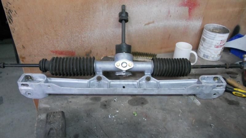

Andreas Johnsen 09-24-2014 02:46 PM
A few pictures of the front suspension out and of it cleaned/painted and put back together.
http://i99.photobucket.com/albums/l2...S/DSCN2456.jpg
http://i99.photobucket.com/albums/l2...S/DSCN2466.jpg
http://i99.photobucket.com/albums/l2...S/DSCN2465.jpg
http://i99.photobucket.com/albums/l2...5.jpg~original
http://i99.photobucket.com/albums/l2...S/DSCN2507.jpg
