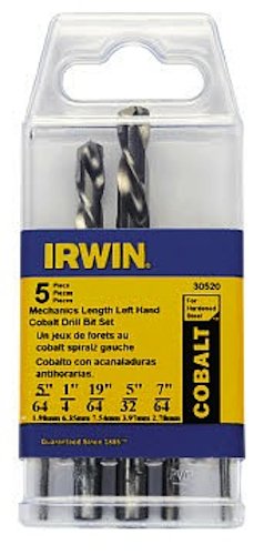

Vern's instructions are very good but I really avoid using easy-outs on anything. They are a last resort as they are very hard, like Kryptonite hard and if they break off you are then really screwed.
I would try heat from a propane torch and a left hand drill bit. As most bits have a few binding moments when using, they usually just unscrew the broken stud as they work. Heat is key, not a lot of heat but enough to allow the aluminum head to grow but not the stud.
Irwin Industrial Tools 11119 Metal Index Spiral Flute Screw Extractors with Left Hand Cobalt Drill Bits Set, 10-Piece - Power Core Drills - Amazon.com
The stud doesn't look flat so a drill guide is and excellent idea. Block up that port so nothing can go down. Be VERY patient and it will work out. Very, very patient....
Good luck!!!

If you can locate some left hand drill bits the next step is easy. Drill them out one size at a time until there is very little sidewall left. They usually spin out by the time you get close to the edge. An Easy out will work well once you get to this point.
