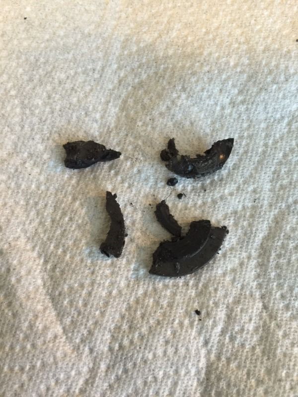

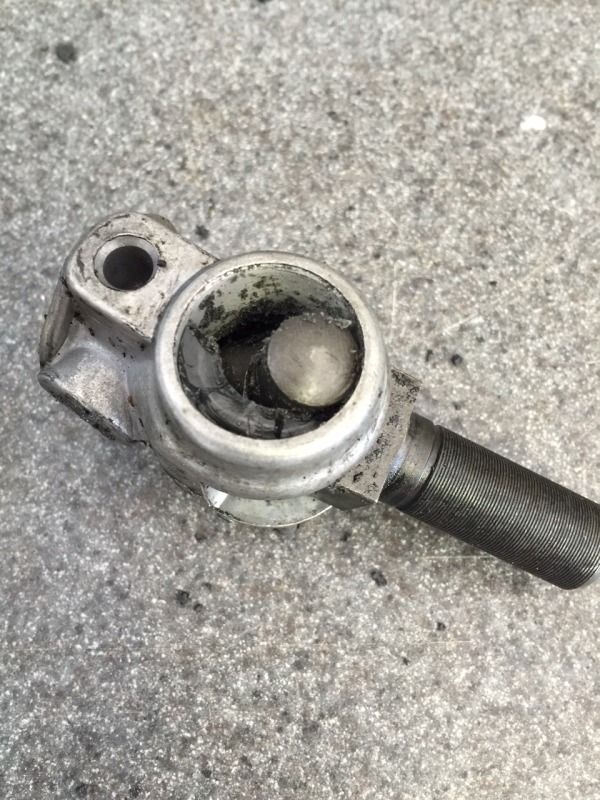

Thanks for the direction. Glad that I found this to be the cause. A quick search and found this and more inside the rubber boot.
Is this bad

bushing.
Is this bad
Yup-Here's was mine............................
also, as per the previous post, replace the shifter bushings.

Removed the bushings. Here are the results. The one's below the shifter look decent, however I'm still replacing them.
