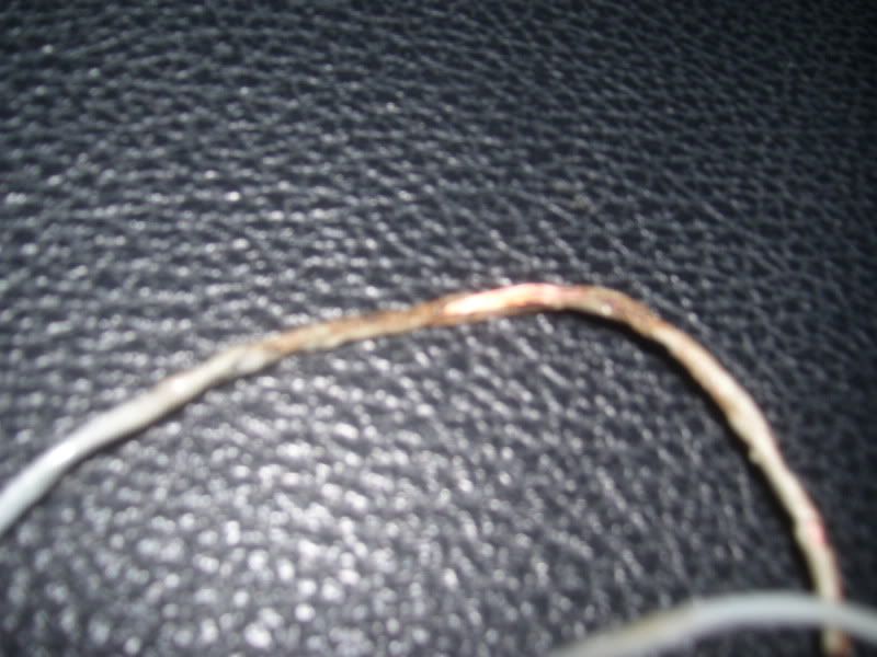

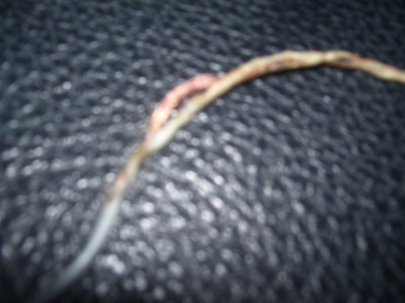

Old 06-26-2015, 10:36 AM
Join Date: Sep 2002
Location: Metro NY
Posts: 3,008
Posting up some crispy wire. Now I need to search on how to remove the glove box so I can trace this wire...
the glove box light is all buggered:
The outside harness sleeve under the ignition key area also was smoking a bit and appears to have some damage. I haven't gotten into it yet
Ken
1986 930 2016 R1200RS

Looks just like mine did. take out your clock you should be able to see some of it. It will then run up into the frunk on the right side and power the light IIRC. Check your interior light fuse. I've gotta $10 says it's the wrong size fuse. I think it should be a yellow but don't recall what the amperage is.

A lot of people don't understand that the fuse protects the wire not the thing the wire runs. A fuse is designed to blow before the amperage exceeds the meltdown point of the wire IIRC. You can stop a fuse from blowing by upping the fuse size but then wires start melting and eventually you either blow the bigger fuse or you have a reason to break out the fire extinguisher. I'd be looking at all of your interior light circuit wire if you can.

Disconnect battery, remove gauges labeling everything, remove dash pad, remove glovebox, remove lower knee pads, become a contortionist looking at things from the trunk and under/inside dash. Etc.
you are going to need access to examine the entire dash area harness due to the routing of the wires that melted and may have damaged wires running with them.
Then it is decision time for replacing with new from Porsche or to have it repaired.
