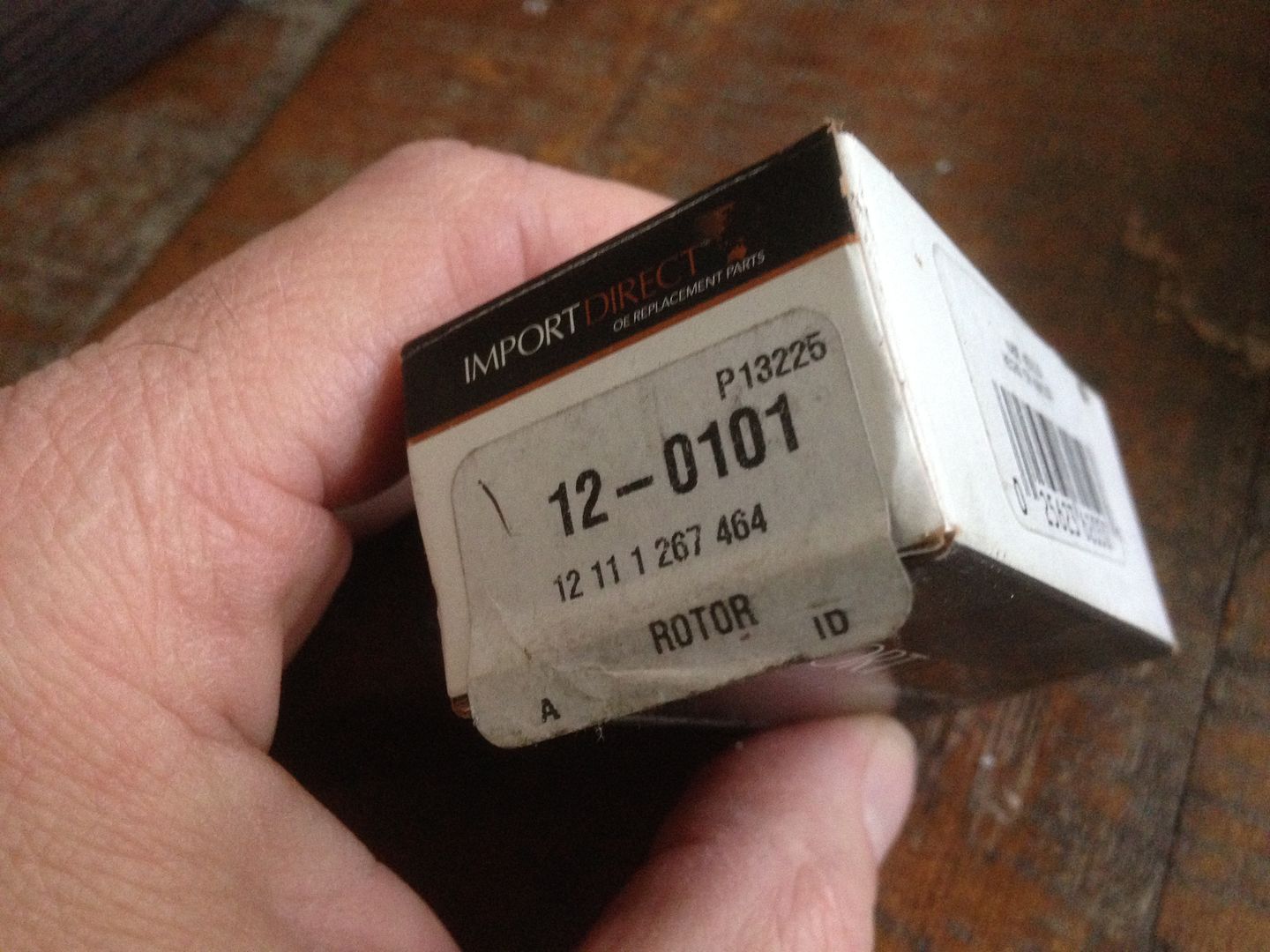

Non-resistor rotor part number?
After my upgrade to a MSD Streetfire ignition I'm in need of a non-resistor rotor. I called our host and they had no idea what I was talking about. Does anyone have the PP part #?
My local Napa is trying to source a EP407 rotor with no luck. Thanks!

Echlin EB 407....just got one the other day at NAPA...btw, the pic shown in their online cat shows a resistor plug (generic photo) but the proper one did show up.

I made my own from a stock SC rotor. Dig out the resin and resistor and solder a copper wire across and you're good to go.
If it makes you feel better you can cover the "repair" with some two part epoxy. I used POR Patch on mine.

Purchased from O Reilly's .

THANK YOU!!! That is exactly what I needed!
