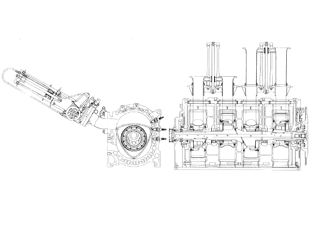

AutoZine Technical School
It seems though that their complexity & cost ultimately brought about their demise.
yes i remember those big cumbersome ones
here is the sexy beast guillotine trombones... mazda and other jpn manufacturehad a whole host of trick intakes during the 80's-90's there production cars. I had an mr2 equipped with one in the 8o's
