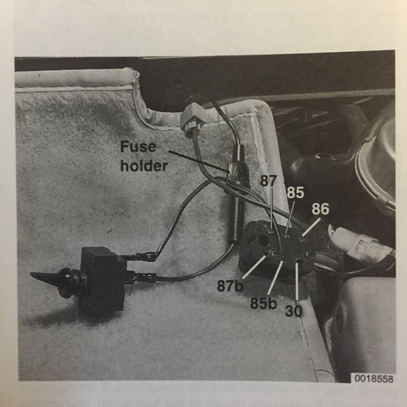

Yes, it is a toggle, "ON OFF" only. So you can control the pump and not leave it on too long without the engine running.

Shown as a Sample Only, I highly recommend you purchase from our gracious Host

Perfect, thanks Draco! So for a short test I can just jumper + fuse it and see if it runs. If so, the relay that should come in the mail this week will sort me out.

Pretty much . Remember do not let it just sit and let the pump run too long with the engine off or you will burn it out.

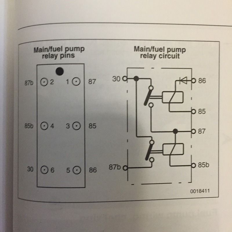

Then, to check the DME relay quickly remove the 35-pin connector from the DME and short pin 20 to pin 19 with a paper clip inside the DME connector. With that when you turn the ignition to ON the fuel pump should come on and you need to be able to hear it running. If not, either the DME relay or the fuse for the fuel pump or the pump are bad.
After that you can fabricate the DME relay jumper IF you determine the DME relay isn't working with the paper clip in the connector.
