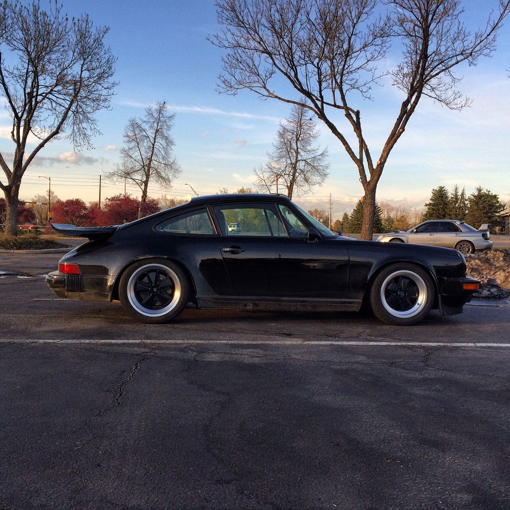

There's no problem with doing this. I ran 8x16s in the front/9x17s in the rear for years. And, since you asked for a pic...

Those are 9s? They look huge! Narrow body? What was the offset? Have a side pic?
Yeah, 9s. Narrow body. I am not exactly sure of the offsets (backspacing), but I believe they are "standard" 5.5" backspacing. The fronts are ~5.75" backspacing. 245/45-16s in the front and 275/40-17s in the rear. Here's a side pic:
I recently (like two weeks ago) refurbished these wheels with some new 17" wheel halves from HRE for my fronts, so now the fronts are 8x17 and I have 225/45s on them. Wheels only:

Looks awesome actually. I assume you went for a narrower sidewall on the 17s? Does having the wider tire and deeper offset mess with your suspension?
My goal at the time was maximizing the amount of tire I could fit in the fenders - hence the 245/275 combo. In reality, the 275/40s were a little tall in the rear, but there weren't (still aren't?) a lot of options for something that wide with an OD at 25" or less.
No ill effects on the suspension. There have been lots of discussions over the years on optimal tire/wheel setups, but having personally experimented with a lot of different combinations, I like the 245/275 combo the best. It is a heckuva lot of tire on a 2400 lbs car.
