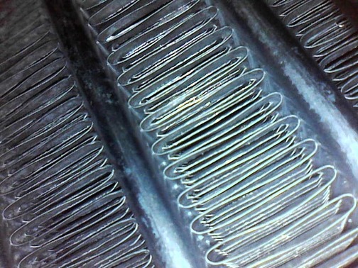

The key is to tell when the evap core is icing up. I imagine you could watch the amp load on the evap motor, when it starts to require less juice that will be a tell tale sign, or measure its rpms ; if it winds up you know you don't have mass as well. Might as well plug in a cheap camera and watch the frost action on the core.
Camera... excellent idea. And simple (which am not used to.) Will admit to being out of ideas at this stage in AC's evolution. Mind has gone into 'completion mode' ...as in get AC working and screw any and all new AC ideas. Exception in the making...
USB Borescope Endoscope for Android - Bamshoot (New Upgraded) Endoscope Inspection Camera 2.0 Megapixels CMOS HD Waterproof IP67 Snake Camera with USB Adpater and 6 Adjustable Led Light - 16.5FT
Several similar units like this on Amazon. Relatively inexpensive.

Iyzer endoscope. 2MP camera. Rechargeable battery---by way of USB cable. Camera's supposedly water proof to IP67 standard (submersion up to 3' for 30 minutes.) Image taking options = still & vid. Adjustable resolution: 320x240, 640x480, 1280x720. Semi-rigid cable = 11.5' length. Amazon purchase... price range for exact same product: $19.99---$69.99. Product received (including box and printed instruction sheet) displays no maker's name, website, or ANY contact info. Zero product support anticipated.
Accessories: mirror, hook, magnet. Hook and magnet don't make much sense as these screw on around camera's head. (Maybe shafts bend?) Mirror works well.
LEDs for power ON and wifi CONNECTED. ...no info provided for battery status. Supposedly battery's good for 40 minutes.
Optimal focal range as I tested it = 2.5” > 4” (product's specs say differently.) Not a clear image outside noted range. LED lights around camera---can adjust brightness with scroll-dial on wifi module---a gotta-have control.
Looking up to bottom of evap. Would prefer to see more evap---wider angle---but cannot get camera any further away from bottom of evap than it is here (unless running it up through plenum's drain---not happening. Cable has been passed through resistor/intake---camera stays in plenum. For $20, is interesting tool to have. $70... not---probably get better quality than this for $70.
