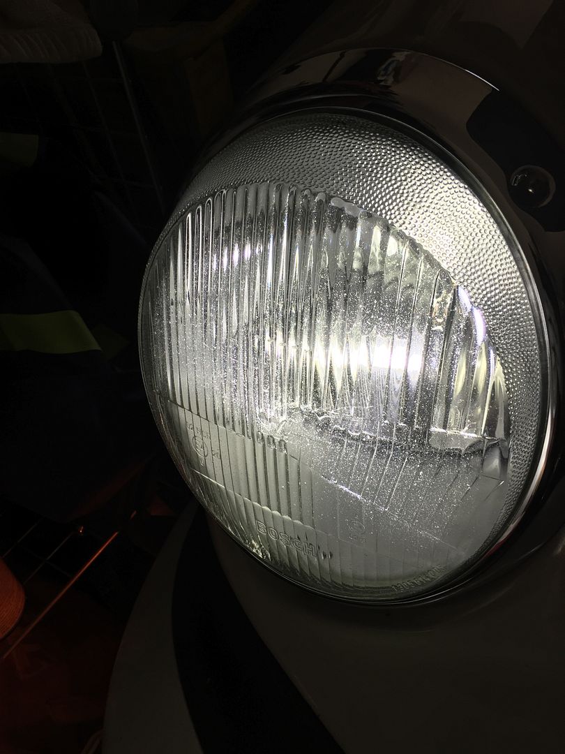

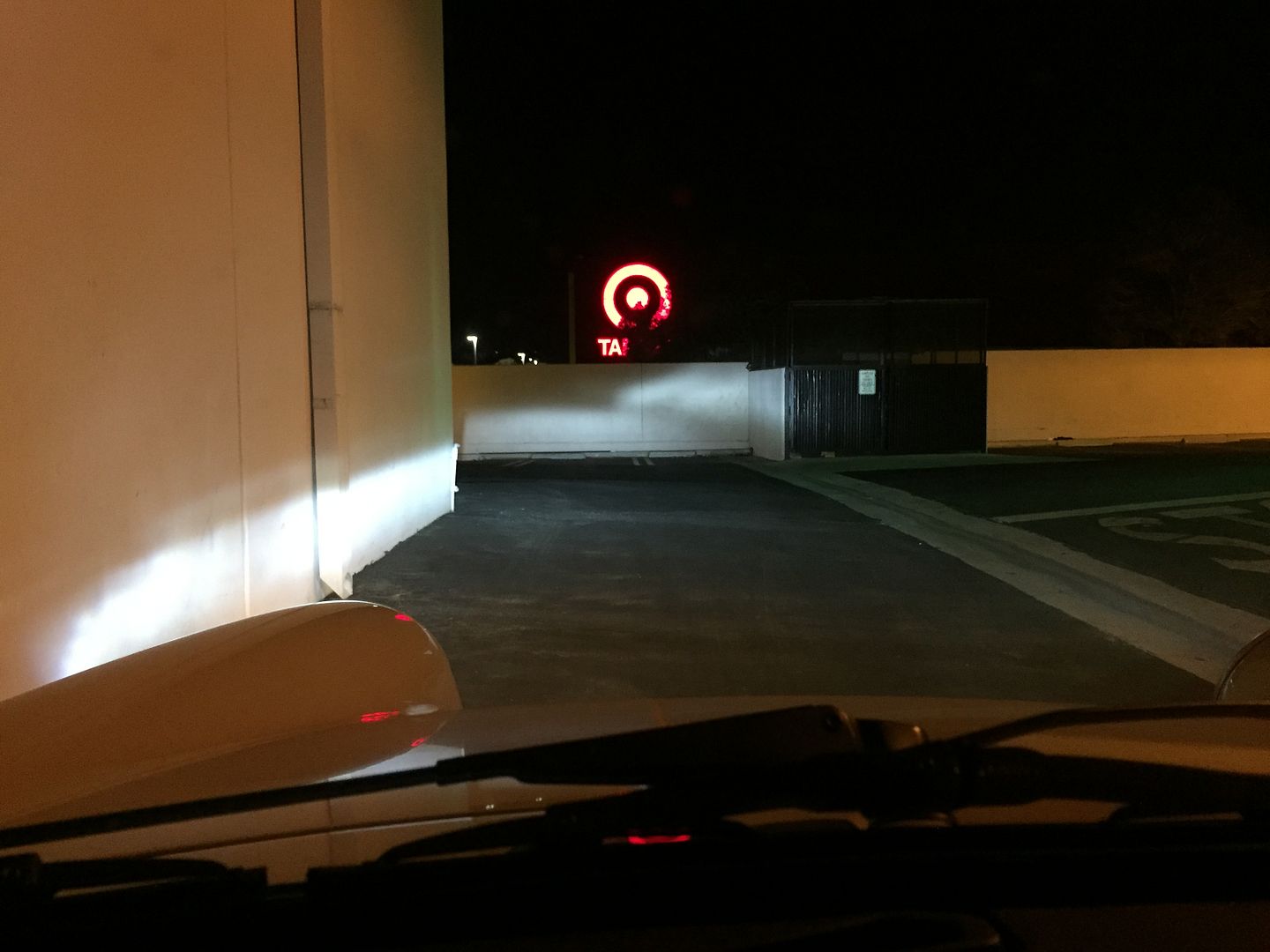

Well to go Euro H4's with Relay and maybe LED kit you will spend $700-800 ( without trim ring )
Here is mine:
'85 Carrera Targa
PCA/POC
Old 10-22-2016, 05:02 PM
Join Date: Jan 2012
Location: Winchester, VA
Posts: 598
Here is mine:
Draco, which LED kit are you using?
Juergen

Sirius Gen 7:
https://www.siriusledlights.com/collections/h4-9003-led/products/7g-led-headlight-h4
I tried the eBay, and they were worse than the stock bulbs. Remember 1 Watt = 100 Lumens as a rule.

Install some clear film on the new lenses so you don't wind up with pitted glass like you see in draco's photo.
Not installing a relay kit on a car with 48 year old wiring seems a bit silly to me.
