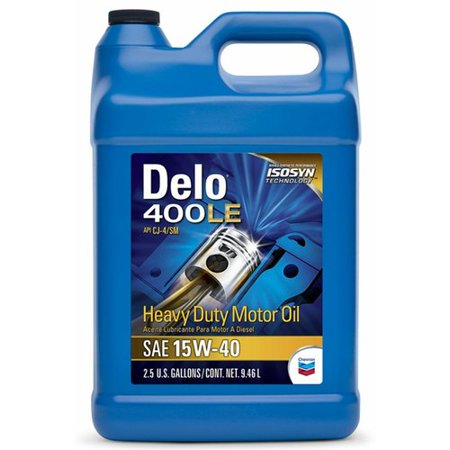

I have been using Delo LE-400 15W-40 which is the new formulation (LE = low emission) that has about 1200 ppm ZDDP. You can access the product data sheet (PDS) here. It says that the zinc by mass percent is .13 and the phosphorus is .12. I think that works out conservatively to about 1200 ppm. I have not checked Rotella but my guess is that they too have similar ZDDP with their new oil formula.
Delo 400 LE SAE 15W-40

The "new" Rotella T4 15w40 Dino oil still has the CJ-4, CI-4+ and SM API service ratings, same as the old Triple Protection Rotella. The new Rotella T5 15w40 semi synthetic has the same service ratings too. Two blends of Rotella 15w40 now.
So it probably has about the same additives as our older Rotella..just different packaging.
When Rotella gets the new API "CK" rating then it will be time to get a virgin oil analysis and see what has changed..right now. no.
I am fond of the Delo 15w40 too, like targalid and Draco. In testing it is very close to a 15w50 and has a great additive package, with a nice dose of Boron and Magnesium too.

3 gallons of Delo 400 LE for sale at Costco for $37.99. Cheaper than any sale I can ever find on Rotella. Plus one for Delo
Checked out the PQIA charts for both Delo and Rotella. Seems like the additive package on Delo is higher on many of minerals our engines would benefit from. Plus two for Delo
Chevron gas is common around the PNW so I can access Delo, especially in the quart size a bit more easily than Rotella. Plus 0.5 more for Delo because there are a lot of Shell stations too!
1500 miles until my next oil change. I used a quart in the first 1500 miles on my 144K mile stock 3.2. I'll compare what comes out at the change and then switch to Delo and start new documentation on Delo usage.

You can get Delo 15w40 in a single jug of 2.5 gallons for $29.00 over at wally world. Just about perfect for a 911.

Delo 400 LE fans: It looks like it's been superseded by Delo 400 SDE and/or Delo 400 XLE... Has anyone used either of them or can interpret the specs vs. LE?
GK
No notes from Chevron about Delo 400LE CJ-4/SM being superseded by another product line and it is still available most anywhere. Delo 400LE is still being promoted on the Chevron website too.https://cglapps.chevron.com/msdspds/PDSDetailPage.aspx?docDataId=415568&docFormat=PDF
Delo 400 SDE is a new 15w40 product line with a CK-4/SN rating..CK-4 heavy duty engine oil specifically formulated for 2017 greenhouse gas (GHG-17) compliant diesel engines designed to meet lower CO2 emissions. It has about 820ppm zinc and 760ppm phosphorus.
Not all manufacturers are jumping on the new CK-4 spec..I suspect the Delo 400LE will be around for a while for the majority over the road trucking fleet.
Delo 400 XLE is a different viscosity 10w30 CJ-4/SM rated oil with 1300ppm zinc and 1100ppm phosphorus.
